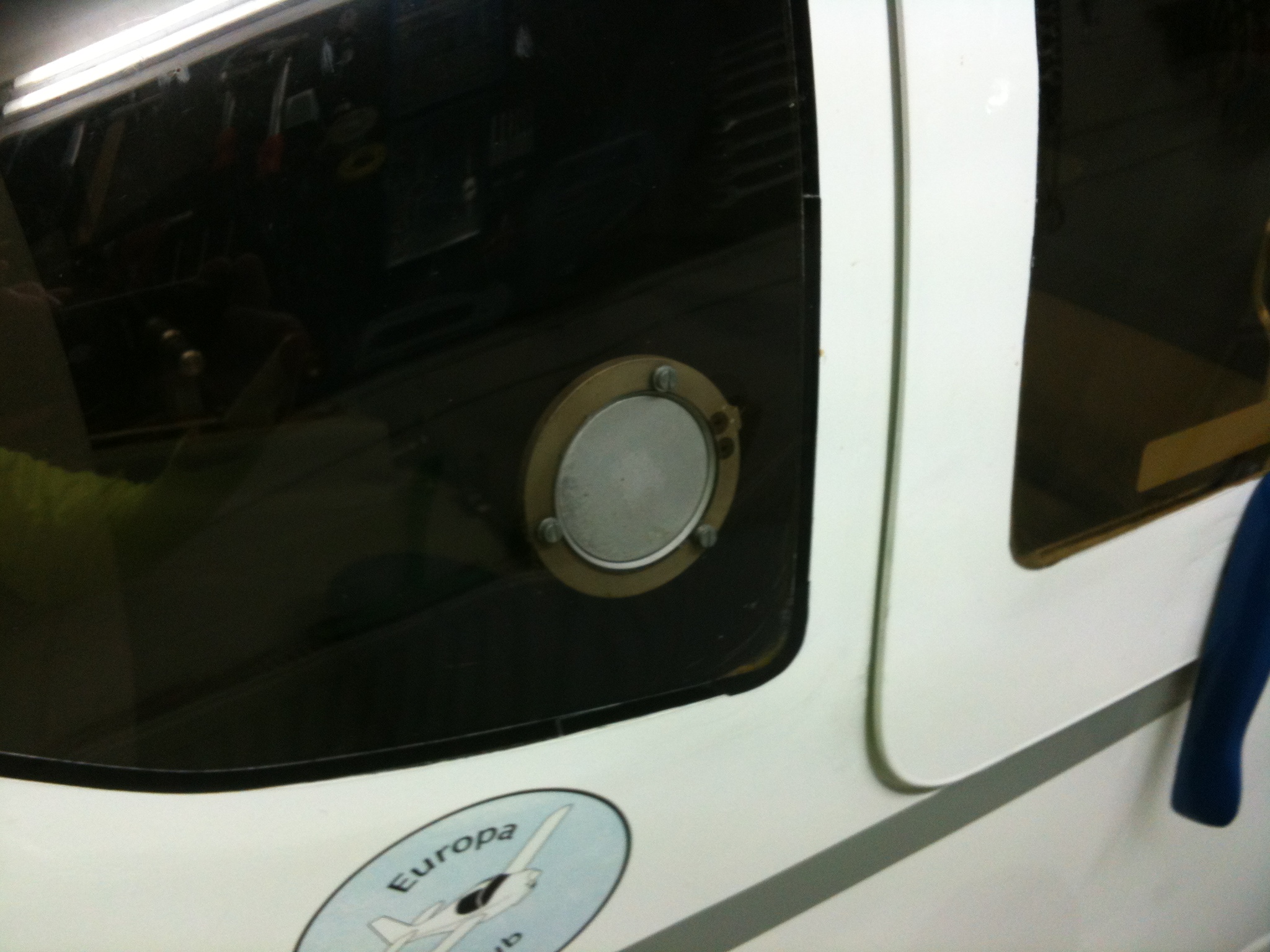

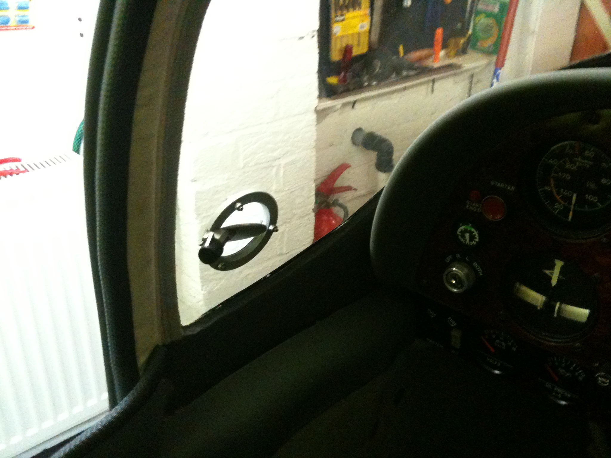

clivesutton
Joined: 23 Jan 2013
Posts: 187
Location: KENILWORTH
PostPosted: Tue Oct 22, 2013 11:54 pm    Post subject: Re: Cockit ventilation Reply with quote
Pete, Tony,
Pics attached. Fully adjustable ventilation from trickle to full hurricane and I've seen this arrangement clear windscreen 'fogging' in no time. But the price . . . Fortunately for me these were already fitted when I bought the a/c. Haven't flown much in rain but I've never had any water leakage btw. Clive
