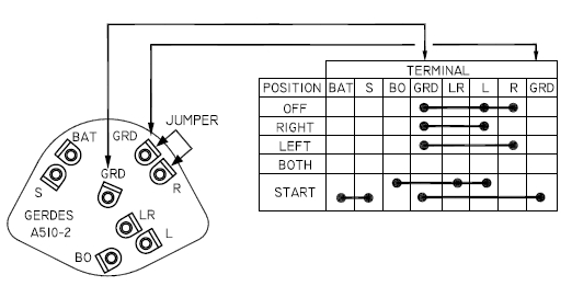

Does anyone know where I can get a schematic of the internal wiring of a TCM Bendix mag/starter switch (BDX 10-357200-1) ?
Thanks - Jay Bannister
Don't know about that particular product but if it's a
classic off-l-r-both-start switch, then it's 99% sure to
be set up like this
[img]cid:7.1.0.9.0.20131025101854.02108e00(at)aeroelectric.com.0[/img]
