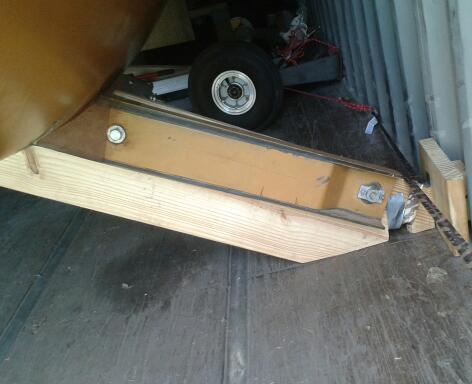

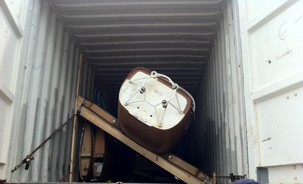

Hi Fabricio
I built a wooden frame that would fit through the doors of the container. It
was basically a rectangle of 6ft by 18ft on the floor and a "wall" 6 ft by
18 ft. I then crossed braced from the bottom to the top corners and bolted
the main spar to the frame. You can then slide the frame into the container.
The frame with the plane on is not heavy and you can easily secure the frame
to the container. You have to remove the landing gear.

Hello Fabricio,
I am the brother of Richard Trickel, the designer and manufacture of KIS aircraft. Congratulations on your purchase of Teds Scotts TR-4 (that is should you go through with the deal). Although I have no experience shipping in a container I did recently move my TR-1C 1200 miles across the USA. I took me a few months to plan the move and a solid month to prepare the rigging to mount to airplane onto a trailer. My brother had vast amount of container shipping experience, he shipped airplanes all over the world. Most of them were in kit form but a few were completed airplanes. In 2006 (I think) He shipped two TR-4s to the big Oshkosh airshow located in the Northern middle of the USA from Pulsars shops in El Salvador. You are correct, the only way to fit a TR-4 in a container is mounting it on a frame to hold it at a 45 degree angle with a slight nose up attitude. Attached is a picture I found on the web of the airplane in the frame. Sorry the resolution of the picture is bad but it shows the frame style you will need to fabricate. It is hard to see much detail but the main landing gear has been removed to fit it into the container. When this airplane was returned to El Salvador somewhere along the way the container was dropped. There were many areas on the wings and fuselage where to cores of the laminated composite skins were crushed and needed extensive repairs. The prop hub was hit so hard they treated it like a prop strike, and they pulled the engine off the airplane for repairs. So I caution you to take extra care and add a lot of padding around all the components, and make sure that everything will remain stationary.
There is one other TR-4 (from Pulsar) in Bauru, Brazil. This airplane should be flying by now. There is also a KIS TR-1 somewhere in Brazil but I am not sure where it is.
If you have any other questions feel free to ask.

I've talked to Ted today and we are thinking on removing the engine from the airframe to reduce the weight and the loads on the fuselage.
We will try to make a frame similar to the one on the picture that Mark have uploaded.

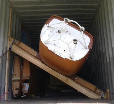

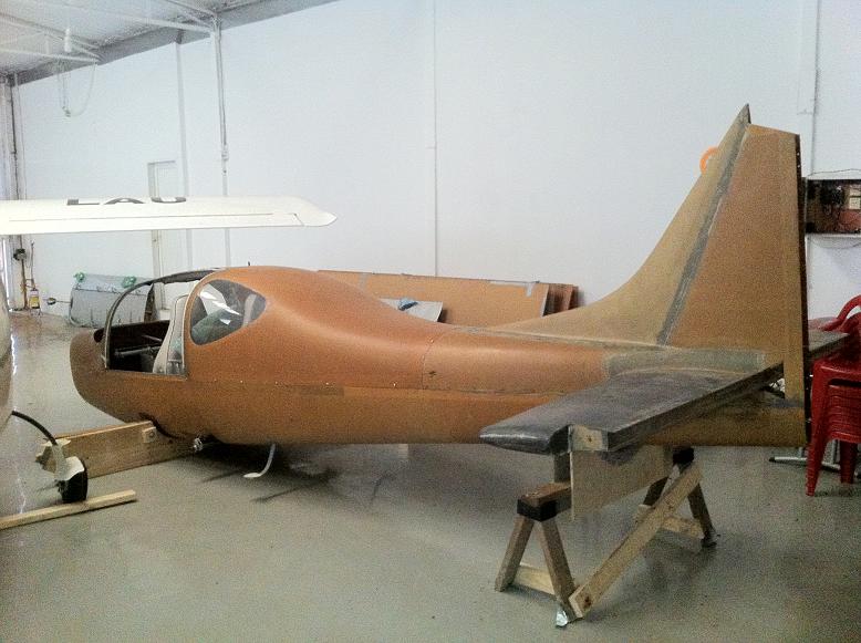

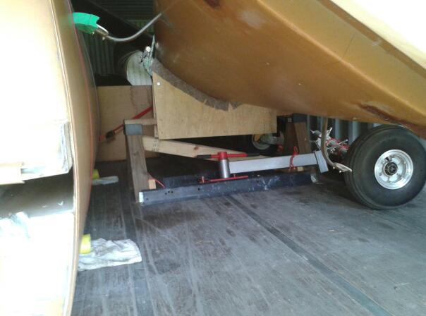

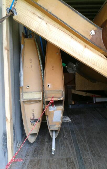

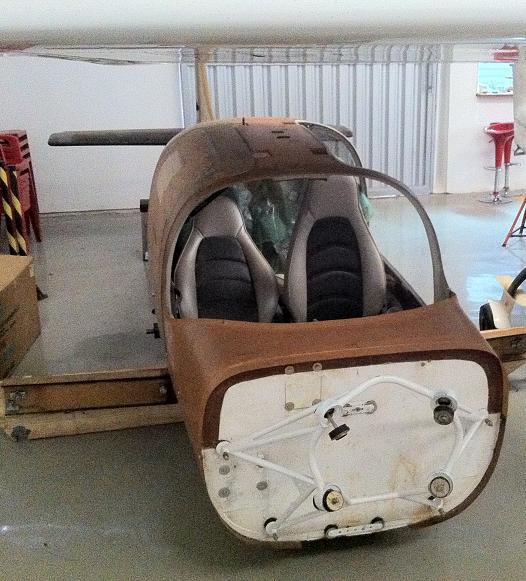

After a huge help from Ted Scott and his very sweet Wife Sita, Tri-R SN 012 is on the way to Brazil.
I'm still at the Nashville airport getting ready to fly back to some and will send more details later.

Looking good now come the nail biting part. I hope it all arrives in the same condition that it left.
Good luck,

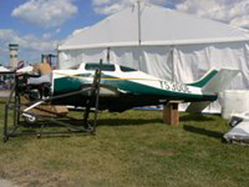

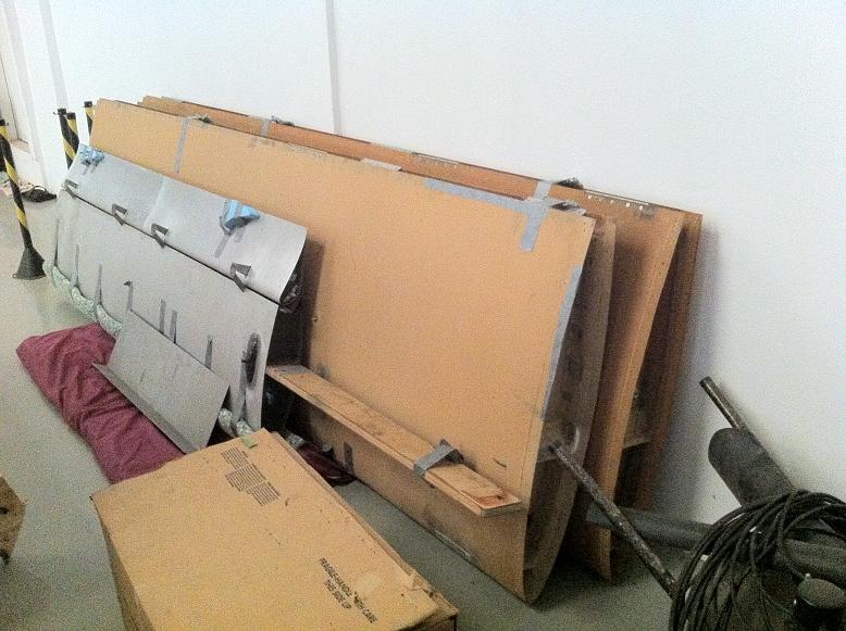

Hello "Kis Family",
After a long time waiting for Customs Process, the TR-4 kit is at our hangar.
Everything was at exactly the same condition that it was when we loaded it in USA.

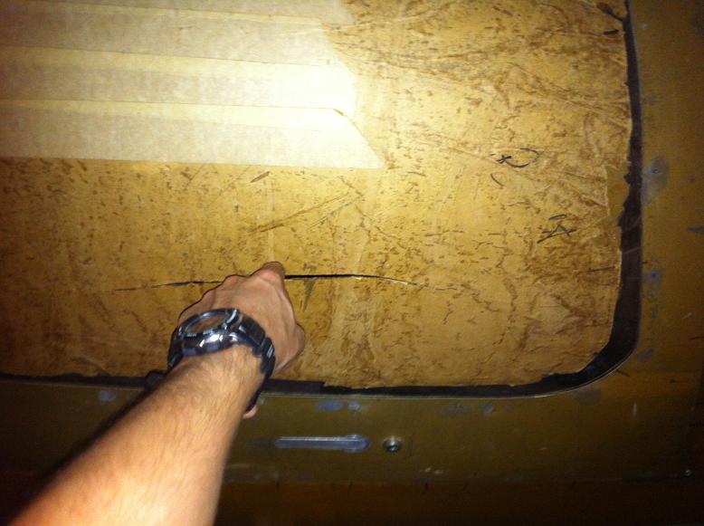

Unfortunately the truck loading crane arm that we've used to remove the fuselage from the container damaged the passenger door window, but I consider it a minor damage after such a long trip.....
I'm sending a few pictures of the aircraft in Brazil. I'll send more later.
Fabricio
In the Container

Fuselage

Wings

Cracked Window

All windows area still available from the original supplier - Aircraft Windshield Company located in Los Alamitos, California, U.S.A. This company retains the original tooling used to make the windows included in KIS kits. When Pulsar was doing business with Aircraft Windshield they never paid their bills so they never got the tooling back, which is very fortunate for all KIS owners as we all can readily obtain replacement windows. Their website is at: http://www.aircraftwindshield.com and they will ship to overseas addresses.
I sent you a PM (personal message) through this forum about a couple of items that need to be addressed on your TR-4, if you did not received it let me know. If you would like the current list of KIS builders and owners I need an email address to send it to. If you PM me your address I will sent it right out to you.

I've sent an email to Aircraft Windshield Company yesterday asking for the price of a new window. I'm waiting for their reply. I'm trying to contact some local windshield company to check if they can make a copy using the original window.
