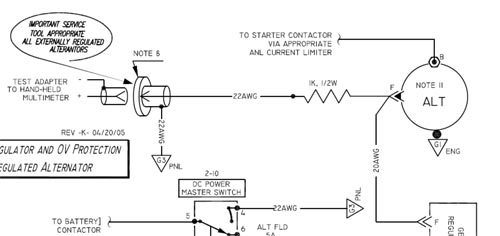

Some years back I suggested that the most valuable
and often least accessible data point for diagnosing
an alternator problem is to watch FIELD VOLTAGE
behavior while putting an alternator through
its paces.
I published this little feature in Z-23 suggesting
a permanently attached wire PROTECTED by a resistor
leading from the alternator field to some handy point
in the cockpit.
[img]cid:.0[/img]
A fuse would be okay too. A 1/4 watt would work but 1/2
watt was mechanically more robust, 1w would have
been better yet. So as long as you don't mind a larger
'lump' in your battery sense lead, a 2W resistor is
okay as well.
http://tinyurl.com/kyc6tq6

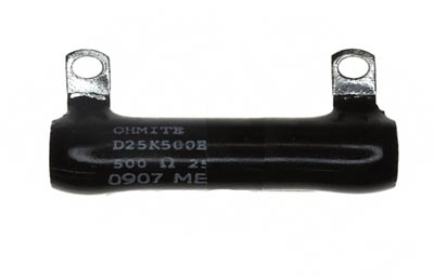

I think it was here on the List that I once suggested
a tubular, 10-watt wire wound resistor with flag
terminals as a suitable enclosure for a reed switch
current sensor.
[img]cid:.1[/img]
The 'jeep' was to put lead wires on the reed switch
then epoxy into place down the center of the tubular
resistor. Then wind an excitation coil around the
center of the resistor over the reed. Calibrate
closure current for the reed by adjusting coil
turns.
In this case, the actual value of the resistor
wasn't critical . . . just needed to be high
enough not to adversely affect current through
the the coil. The resistor became a robust
'housing' for the current sense relay offering
a convenient terminals to tie off ends
of the coil.
