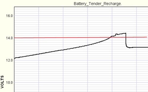

I found some test data I gathered on two wall-warts
(a Tender and a Minder) along with the Schumacher 1562
[img]cid:7.1.0.9.0.20131023133031.02075268(at)aeroelectric.com.3[/img]

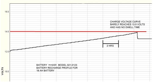

A Battery Minder I tested does not appear to accomplish a true
top-off cycle. On the other hand, the Battery Tender does seem to
conduct a top-off . . .

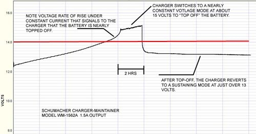

But the real value in $low$ charger/maintainers seems to be the
Schumacher 1562
[img]cid:7.1.0.9.0.20131023133031.02075268(at)aeroelectric.com.5[/img]
The 1562 is about 2/3 the cost of the wall-warts, about twice
the "initial charge" rate and exhibits a robust/practical
implementation of a top-off cycle.

Data shown above gives me pause to wonder if people do not make a
distinction between Battery Tenders and Battery Minders.
It's the Battery Minder that may be the bad-boy on the
street.

My good friend Skip Koss at Concorde reminds
me that the Battery Minder brand has expanded
over the years to include a constellation of battery
maintenance products.
http://tinyurl.com/mzn8z92
Skip says Concorde has evaluated and endorsed the S2
model for their batteries . . . he said and I
quote, "Bob, the charge curve on the 1562 looks like
the BatteryMINDER “S2” curve that we endorse,
except that the BatteryMINDER has an ambient temperature
sensor that regulates the charging and float (OCV)
voltage at temperatures from -40 to 140F perfectly,
can be and SHOULD be left on these hanger queens
24/7 and their batteries will last them 8-10 years."
No doubt the data under which we've labored
since I pitched a BatteryMinder wall wart based on
a gimpy recharge curve 10 years ago is probably
invalid. Everybody has had a chance to
run the marketplace race and I suspect that the
original prohibitions against BatteryMinder
are inappropriate.
Similarly, Battery Tender's stable of products
has blossomed too.
http://tinyurl.com/q6qq637
Bottom line is that either of these brands have
earned a fresh look at present performance.
It's highly probable that Schumacher's technology
has evolved as well. I'll pick up a new 1562
and run the plot. Until more data is known,
my opinion as to the performance/value of this
product is unchanged . . . but new numbers could
break that bubble in a heartbeat.
