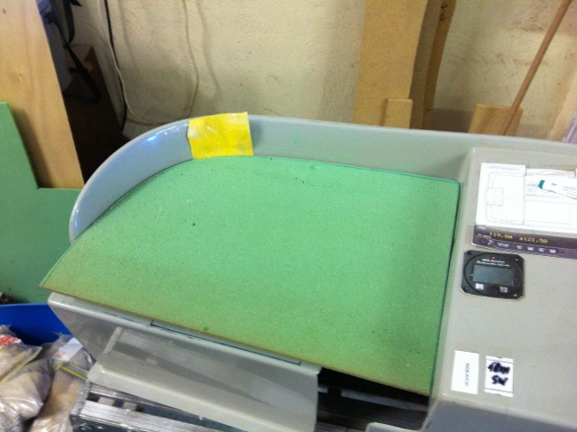

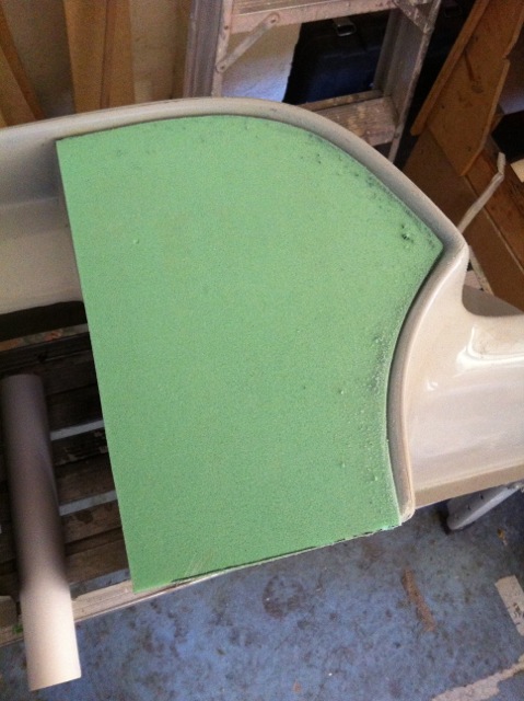

Great.Thanks for that. Look fwd to the vid. At a similar stage it seems with our panels. I am going to have the two standard removable panels. Here is how I shaped my templates.

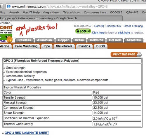

Next I am going to use
http://www.onlinemetals.com/merchant.cfm?id=1264&step=2&top_cat=181
for my panel.
