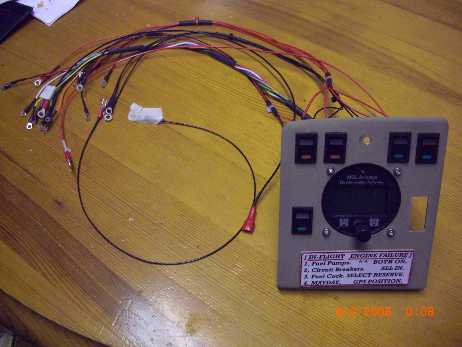

Alan Carter
Joined: 02 Jul 2012
Posts: 378
Location: Kent, England.
PostPosted: Wed Oct 23, 2013 8:47 am    Post subject: Re: Terminal Block. Reply with quote
Hi Barry, Rodger.
I have posted photo so you can see what I am doing.
Basically I am fitting a Fuel flow meter to the aircraft, my plan is for me to make up the gauge panel plus some illuminated switches and do all the cosmetic work plus fitting all the components in place like the 2 senders and get it wired up, keeping the plane flyable so as I can use it.
Then at a later stage get my inspector to come over, and finish off, do the fuel pipe line work, flow tests, and sign it off.
As you can see lots of grounds wires from the switch LEDs, etc,
I can make about 4 or 5 lugs per terminal, this is why I want to make use of the terminal blocks fixing bolts, and use them as extra terminals,
And yes they do fix into Fibre Glass,
I am thinking it will be all OK , but just to be sure but this post in.
Regards.
Alan

PostPosted: Wed Oct 23, 2013 1:51 pm    Post subject: Terminal Block. Reply with quote
Alan
Not clear what type of terminal block you mean but if you are
using the fixing bolts make sure you clamp the ring terminals between nuts
not against the fiber glass.
As you are in UK Parts for aircraft sell busbar blocks with 5, 8 & 10
terminals. & aircraft grade wire
http://www.parts4aircraft.com/PBSCCatalog.asp?ActionID=67174912&PBCATID=1543515&PBCATName=Sockets,%20Plugs%20and%20Bus%20Bar
Are you using coloured aircraft or pvc ?
- The Matronics RotaxEngines-List Email Forum -
http://www.matronics.com/Navigator?RotaxEngines-List
Alan Carter
Joined: 02 Jul 2012
Posts: 378
PostPosted: Wed Oct 23, 2013 2:23 pm    Post subject: Re: Terminal Block. Reply with quote
Hi,
Its a 10 pin terminal block, and yes I would bolt the eyelets up between the nuts.
I can see no reason why this should not be fine, all bolted up tightly together. But I had this thought in my head.
It was just a thought that maybe not using the terminal block itself, but using the fibre glass of the instrument panel may induce some electrical charge into it, and make it more sensitive to a lighting strike, most probably not , but just wanted to check it out.
