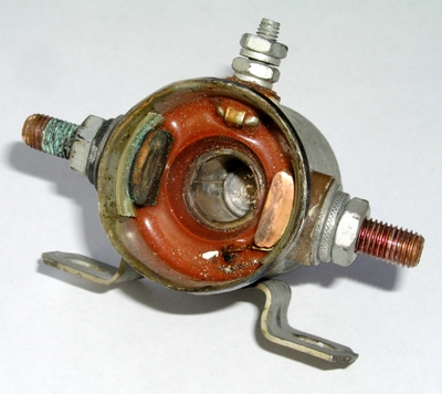

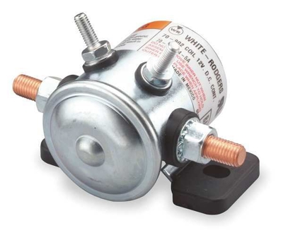

I delayed joining this thread because I recalled
a conversation we had here on the List some time
back about contactors opening up under vibration . . .
actually shock.
That conversation spooled up after a builder posted
a note stating that while working on his
airplane, battery-only, he dropped a tool on his
battery contactor and the EFIS rebooted. He repeated
the experiment several times and then came to the
List to inquire into the suitability of this device
to its intended task.
Of course, many tens of thousands of this style
contactor had been used as battery master control
on light airplanes for close to a century. Several
companies offered similar products but most notably,
White-Rodgers/Stancore and Cole-Hersee. The builder's
problem presented in a Cole-Hersee part he had
purchased from Van's.
I had an exemplar C-H part which I set up on the bench
not unlike Eric's experiment above. I was astounded to discover
that what I thought was a relatively light tap with a
box-wrench caused a demonstrable discontinuity in the
contactor's conductivity.
Hmmmm . . . bad contactor? I was selling W-R/S contactors
at the time so I put one of those on the same test set up
and guess what? It did it too.
"Holy contacts Batman, how can this be?"
After some thought I came to two understandings about
the nature of this phenomenon. First, striking the steel
enclosure of the contactor with a steel tool was a
shock force. In terms of g-levels it could have easily
reached the big numbers. Certainly 10Gs and 100G would
not have surprised me.
Second, why did this not manifest before? Answer, it HAD,
many, many times over the decades. But all of the
applications that made these contactors popular DID NOT
feature solid state electronics . . . particularly
fitted with microprocessors that would re-set on
microsecond notice.
Then the lights came on. At some time toward the end
of my tenure in the sales of contactors, W-R/S modified
their 70 series devices to add plastic booties over
the mounting feet.
[img]cid:.0[/img]
I wrote to W-R/C and called a rep to see if I could
get an explanation for why those 'insulators' were
added to the mounting. Never got a satisfactory
answer . . . in fact never got any answer.
But I'll be you $5 to your donut (used to be
a dollar . . . but you know . . . inflation),
that some new electric vehicle with modern,
CPU driven controls demonstrated the same phenomenon
reported by our brother builder in his
airplane. The good folks at W-R/S couldn't do a thing
about failure of some manufacturer to do DO-160
style qualification to his fork lift controller
. . . the next best thing was to modify the contactor
for better resistance to hi-G pulses or shock.
Of course, hitting the contactor with a wrench
continues to produce the same demonstrable dis-
continuity. The difference being that the same
shocks delivered through the mounting feet are less
likely to interrupt the flow of power through
the contactor.
What's the likelihood of delivering such 10+
G shock to the contactor in your airplane?
VERY low, hence the exemplar service life of
this device in airplanes . . . even machines
fitted with electronics having twitchy reset
characteristics.
Nonetheless, the discovery was a surprise. At the
time I was engaged in some relay life issues at
Hawker-Beech and this discovery on the contactors
prompted some explorations into smaller relays . . .
particularly some mil-spec devices. Guess what?
They do it too.
I couldn't find the data plots I took on the contactor
experiments. If I run across them in the future, I'll
re-post this note alone with the data. I don't
think I recorded any data on the $high$ relays,
those investigations were never formally reported.
Bottom line is that shock . . . fast rise, short duration
high intensity transients are a special kind of
vibration that gets spec'ed separately from the
shake, rattle and roll of the airframe. This further
emphasizes the need for good practice in the design
of input power conditioning for particularly
vulnerable avionics. Design practice that should
happen INSIDE the box at the factory . . . not
outside the box at the airplane.
So the short answer to the topic question of this
thread is, yes . . . plain vanilla contactors
and relays are just as suited to control "critical"
power as they ever were. The companion question is
whether or not the designers of potentially vulnerable
systems understood and considered the wild-and-wooly
nature of DC power systems in all manner of vehicle.
I have referred numerous non-aviation clients to
DO-160 as a set of exemplar guidelines for successful
marketing of a new product.

I received a failed, 70-series contactor removed from
a 70's model Cessna. The owner believed that it was
the original contactor. We did a tear down and discovered
that indeed, the contacts had become intermittent due
to corrosion on contacts exacerbated by ingress of moisture.
Mechanically the device was intact and functional . . .
after 30+ years of service.
[img]cid:.0[/img]

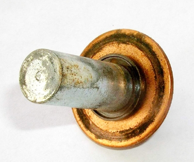

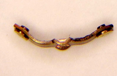

Here's the mating set of contacts . . .
[img]cid:.1[/img]
For a device that has been operated for 30+ years
"outside the spec sheet" envelope of limits it looks
pretty good to me. Would this Cessna owner be well
advised to install something "better"?

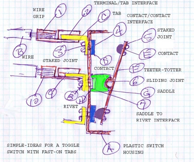

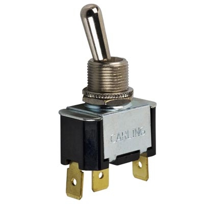

We gave up these switches
[img]cid:.0[/img]

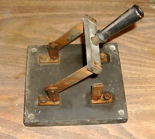

in favor of these . . .
[img]cid:.1[/img]
For reasons that are fairly obvious. But consider
the constellation of simple-ideas that come with
the use of this part in your airplane:
[img]cid:.2[/img]
There are 10 new metallic joints added to every
current carrying path by the use of these switches.
That's a fist-full of new opportunities for failure.

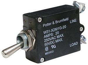

These switches HAVE suffered some interesting
failures . . .
[img]cid:.3[/img]

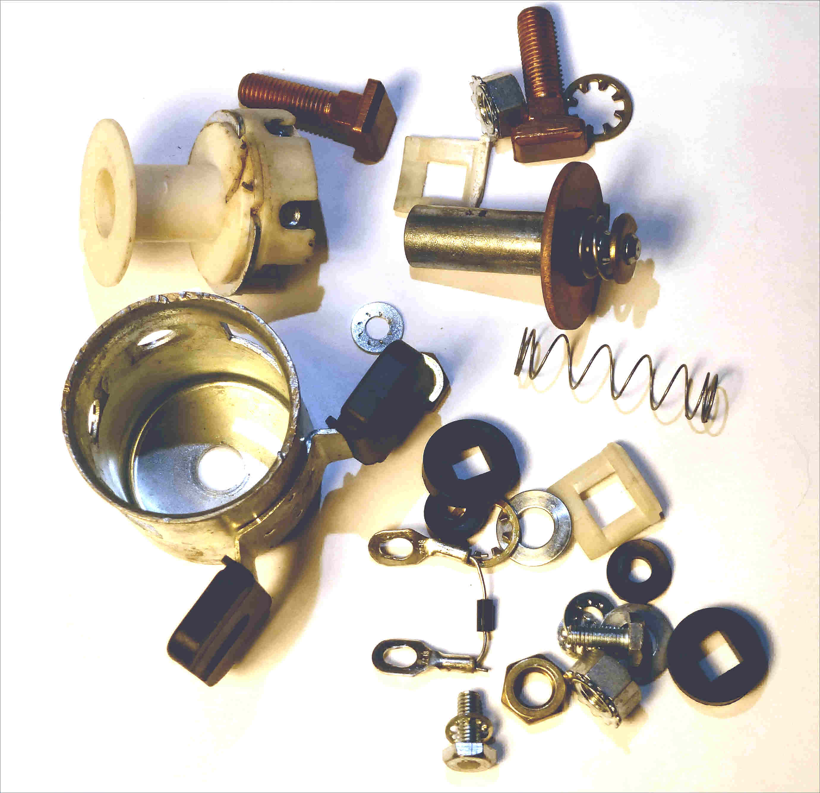

PostPosted: Sun Oct 20, 2013 8:03 am    Post subject: Re: Relay for Critical Power Feed Reply with quote
Attached disassembled Type-70 (minus cap).
Type-70 contactor

PostPosted: Sun Oct 20, 2013 8:10 am    Post subject: Re: Relay for Critical Power Feed Reply with quote
Attached disassembled Type-70 (minus cap and copper coil). A long cost-cutting way down from the part you show.
Type-70 contactor

"Better" is non quantitative. Just a few weeks ago
[img]cid:7.1.0.9.0.20131020113308.02102cf0(at)aeroelectric.com.7[/img]
[img]cid:7.1.0.9.0.20131020113308.02102cf0(at)aeroelectric.com.8[/img]
[img]cid:7.1.0.9.0.20131020113308.02102cf0(at)aeroelectric.com.9[/img]
[img]cid:7.1.0.9.0.20131020113308.02102cf0(at)aeroelectric.com.10[/img]
Really?
Are we privy to the conversations that transpired
during the last 50 years worth of engineering/management/
manufacturing/marketing meetings wherein the design
features of this product like were decided?
I'll invite our readers to review the library of
70 series photos at http://tinyurl.com/kcc26jt
These photos only go back to about 1960 . . . it seems
likely that a 1940 tear-down would show yet other
differences.
I would guess that this product line has
enjoyed a host of cost-cutting changes. Advancements
in materials and automation are nearly always
responsible for reductions in cost and/or improvements
in meeting design goals.
But consider that of the trio of failure teardowns
illustrated in the library of pictures, 2 failures
were the result of assembly error . . . a human
factor I cited earlier today. The third failure
occurred at or beyond any practical expectations
for service life on the product . . . the thing
operated as designed and expired gracefully
(random intermittent). Further it was not a player
in the classic trio of conditions that precede
so many sad events in aviation and elsewhere.
You seem to use the phrase "cost cutting" as
an epithet. I have participated in dozens of
tasks where cost-cutting was a mission
imperative. However, in no instance was degradation
of service life or performance considered a
component of the acceptable solution. More often
than not, the upgrade reduced costs while improving
on the value of the product.
