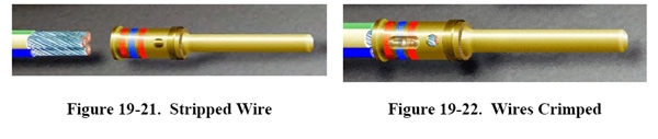

At Hawker-Beech we had automated wire cutting, marking,
stripping and termination machines that produced thousands
of ready-to-install wire segments a day. None of these machines
had a 'twisting' function. The as-stripped strands were
immediately fitted with the appropriate terminal and
crimped.
A review of NASA-STD-8739.4 for the fabrication of wire
bundles and terminations, I found no example for terminating
wires were either single or multiple wires were twisted
by the installer before attaching a terminal.
[img]cid:.0[/img]
I've never witnessed such a practice by technicians nor am I aware
of a rationale for doing so.

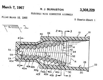

In fact, the 'wire nut' designed for wiring of buildings
achieves gas tight connections at the corners of a square-
wire, conical-spring. As the device is twisted
over the ends of parallel strands, the cone expands and
crawls up and over the ends of the cut strands.
An early example of this technology was not insulated.
[img]cid:.0[/img]
A conical spring wound of round wire and fitted
with a 'handle' was simply wound onto parallel
strands. The counter-wind torque expanded the
spring up and over the strands thus increasing
the pressure that kept the wires in good contact.
Later versions deleted the handle, added insulating
cap that also served as a handle . . .
[img]cid:.1[/img]
They also wound the spring with square wire having
a corner turned in. This sharp edge would bite into
the strands of wire thus increasing both mechanical
grip for running the spring onto the strands AND
increasing the numbers of high-pressure (gas tight)
joints between conducting elements of the connection.
None of these products would benefit from a pre-twisting
of the wires before installation. Standard practice calls
for twisting the cap on until the strands DO twist slightly,
say 1/2 turn or so. This is your installation limit indicator
that the spring is no longer climbing onto the wires and
further rotation serves only to twist the bundle which
adds nothing to the quality of the finished joint.
Therefore, the short answer for any kind of installer-
twisting of strands in a wire or wires in a bundle
seems to be "not necessary and possibly deleterious
to the finished joint."
