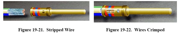

A review of NASA-STD-8739.4 for the fabrication of wire
bundles and terminations, I found no example for terminating
wires were either single or multiple wires were twisted
by the installer before attaching a terminal.
[img]cid:7.1.0.9.0.20131019195801.03cc6438(at)aeroelectric.com.2[/img]
I've never witnessed such a practice by technicians nor am I aware
of a rationale for doing so.

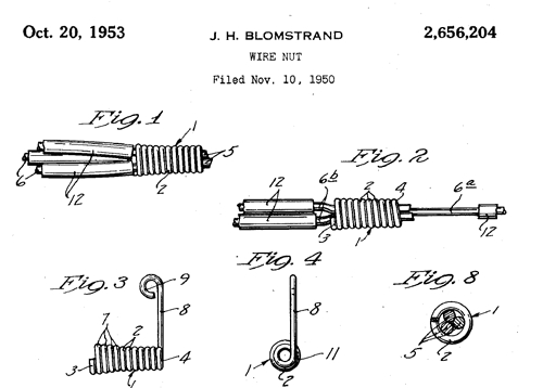

[img]cid:7.1.0.9.0.20131019195801.03cc6438(at)aeroelectric.com.3[/img]
A conical spring wound of round wire and fitted
with a 'handle' was simply wound onto parallel
strands. The counter-wind torque expanded the
spring up and over the strands thus increasing
the pressure that kept the wires in good contact.
Later versions deleted the handle, added insulating
cap that also served as a handle . . .

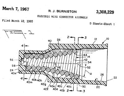

[img]cid:7.1.0.9.0.20131019195801.03cc6438(at)aeroelectric.com.4[/img]
They also wound the spring with square wire having
a corner turned in. This sharp edge would bite into
the strands of wire thus increasing both mechanical
grip for running the spring onto the strands AND
increasing the numbers of high-pressure (gas tight)
joints between conducting elements of the connection.
None of these products would benefit from a pre-twisting
of the wires before installation. Standard practice calls
for twisting the cap on until the strands DO twist slightly,
say 1/2 turn or so. This is your installation limit indicator
that the spring is no longer climbing onto the wires and
further rotation serves only to twist the bundle which
adds nothing to the quality of the finished joint.
