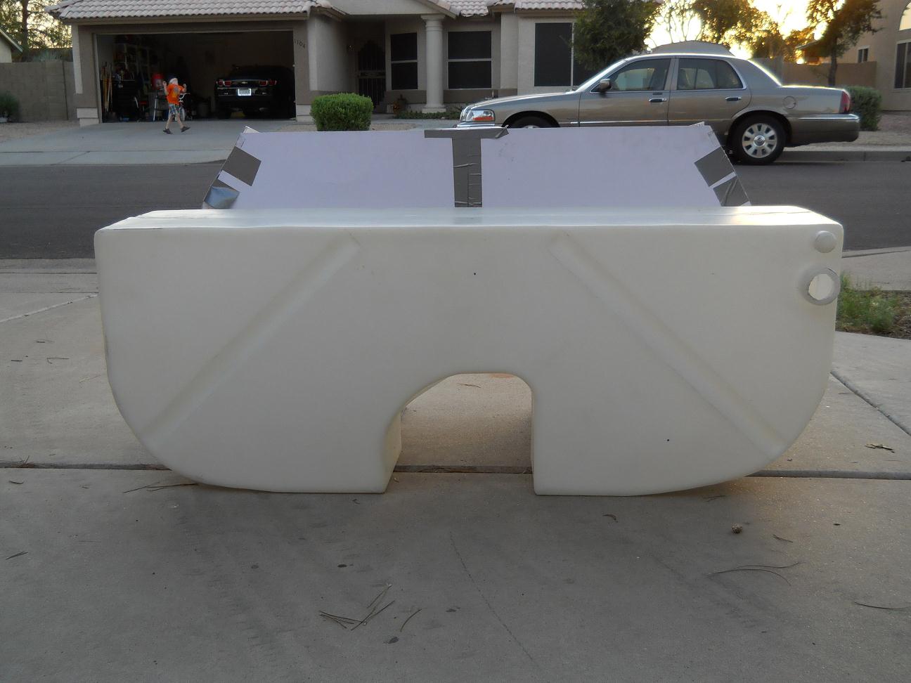

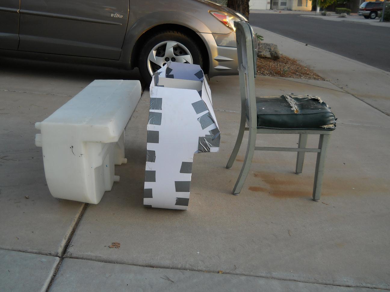

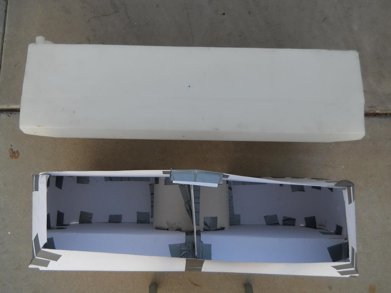

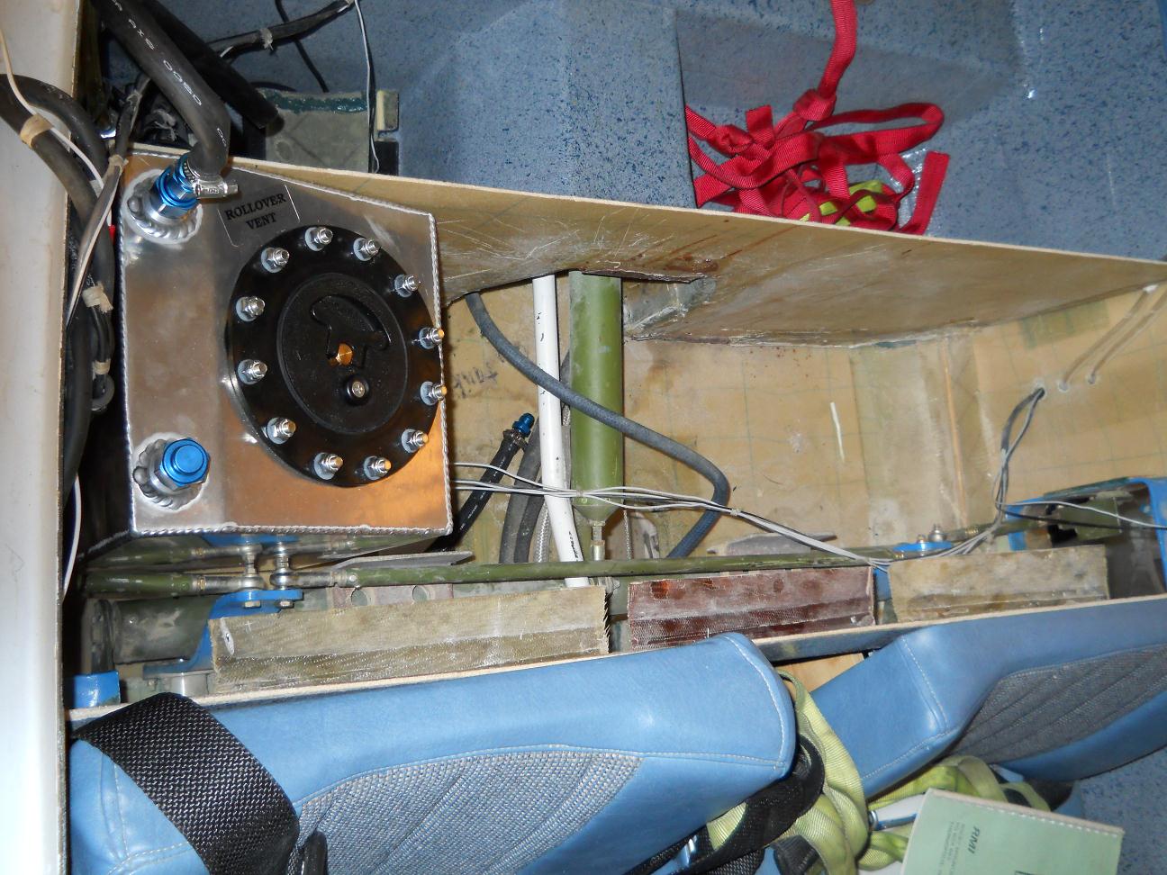

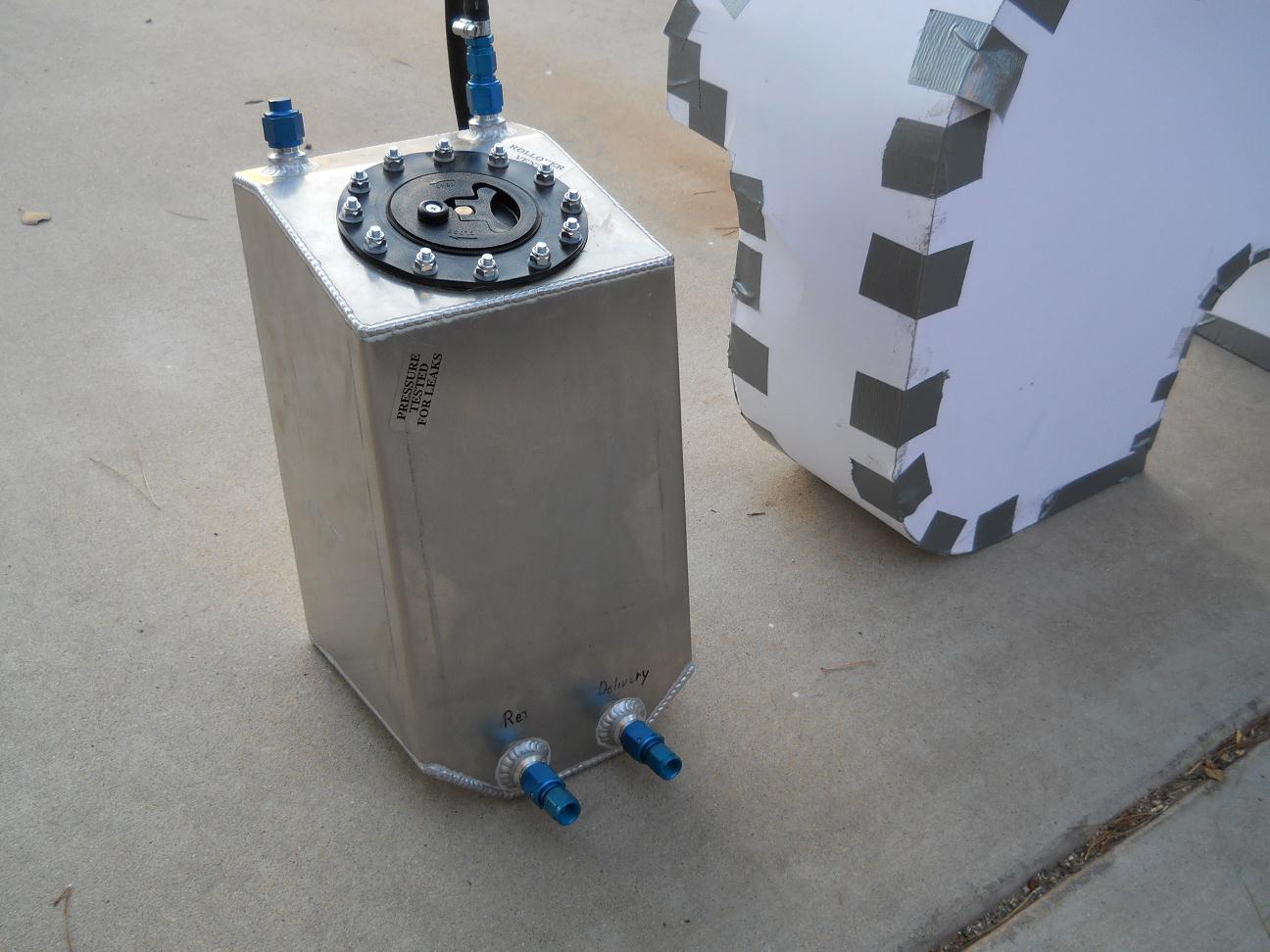

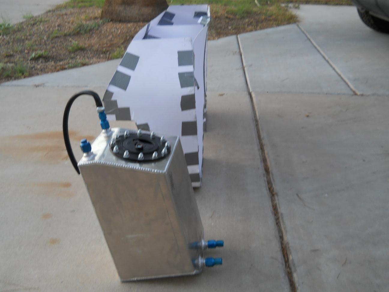

More photos
A143
Steve

built a tank out of 5251 quarter-hard magnesium alloy.
It weighs 7850 grams and has a capacity of 110 litres.
I incorporated internal baffles, and breathers with proper AN fittings
to accommodate alloy pipework. It is also fitted with a full length
capacitive probe and four solid-state optical fuel level sensors.

The only advice I would offer is: allow yourself a long time to make and perfect your cardboard templates - the fuselage is partly conical in section so the development will be an interesting shape. Choose a welder based on his ability to weld alloy and don't fall into the trap I did of restricting yourself to a CAA approved welder whose self-belief exceeded his ability!

Steve...I like your thinking regarding your design for an aluminum fuel tank, but I'm a little confused by the small tank with the large filler at the top. Was this some sort of a trial?...or is it a companion to the large tank?
Fred
