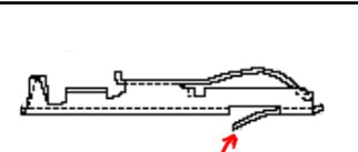

How many terminals do you need to extract?
The tool size is not critical . . . it needs
to fit inside the width of the slot in the
connector housing and be no thicker than the
depth of the slot. It's a thin blade that
is used to depress the retention tang
on the pin.
[img]cid:7.1.0.9.0.20131104131604.049c16c0(at)aeroelectric.com.0[/img]
Unless you have bunch of terminals to pull,
suggest you try a sewing needle inserted into
the center of the slot. The tang is only about
.4" inside and not hard to reach.

Bob, Thank you for your response. Fortunately, I have only two terminals to extract.
I was hoping to get measurements of the actual tool; especially the blade thickness, so the contact would release easily, yet I wouldn’t have to worry about permanently deforming the retainer clip. Also, I don’t have a spare Bendix/King card edge connector body to give me the slot width, but I could probably guesstimate that.
My idea was to cut a sliver of shim stock. Do YOU have a guess as to blade thickness of this tool?
Yes, I may have to resort to the sewing needle approach, but I don’t know if these old eyes will be able to keep the needle centered in the slot. Besides, trying different sizes, I can ruin only so many of my wife’s sewing needles before there is hell to pay.
There is possibility of 'flattening' the
clip even when the 'right tool' is used.
I always tweak the clip to increase it's
grip before re-inserting a used terminal
back into the housing.
I don't think I've ever actually measured one.
The last two that I made were fabricated from
flat spring stock cabbaged from a pocket tape
measure. I used a cutoff wheel in a Dremel to
sculpt the material.
Many moons ago I published this offering
Vhttp://tinyurl.com/nknv4bk
I believe these numbers were suited to
the various versions of this pin retention
methodology . . . but that was some time ago.
Get your own needles. In fact, I think
sewing machine needles are about the right
thickness and they offer a 'handle' of sorts
on the machine end. Again, a little sculpting
with a Dremel would tailor them to the task.
