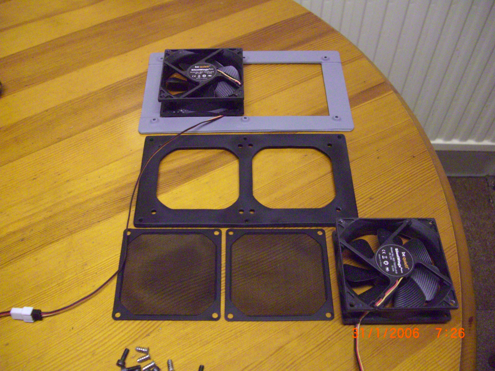

Two 92 mm Fans, Two Fan grills, Piece of alloy sheet, 6 Allen Bolts and lock nuts, Araldite, and maybe some little bits of Wood.
You can my parts in Photo,
Mark out and Cut the letter box out, with an opening to take the two fans.
Mark out and Make the Fan plate, mark out and cut out the shapes,
Drill the holes and fit the Fans and grills, to the plate.
Drop into letter box and drill fixing holes for Allen bolts, Allen bolts are used as you can remove with the windscreen in place.
To anchor these bolts, i used a strip of alloy drilling and filing the shape of each of the six nuts in the strip and bonding with Araldite.
As the fans are 25 mm in depth i had to raise the fan plate about 1/4” by Aralditing a strip of wood round the edge to raise the fan clear of an instrument.
Clean up and paint,
Does not look much but it took me about 8 hours so far.

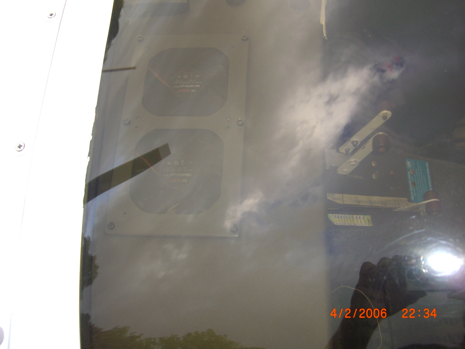

Mask Windscreen , work carefully use letter box to mark, then cut hole, thought this was plastic, Stanley Knife did not work, ended up cutting with half an hack Saw Blade
small file, and sand paper,its actually made of Glass Fibre and a bit tougher than i thought.
Make the six fixing holes in Glass fibre, then slid Letter Box underside and Araldite up, hold in place with bull dog clips,
When set screw in Fan plate and wire up.
Serves two purposes, maintenance panel and demister,

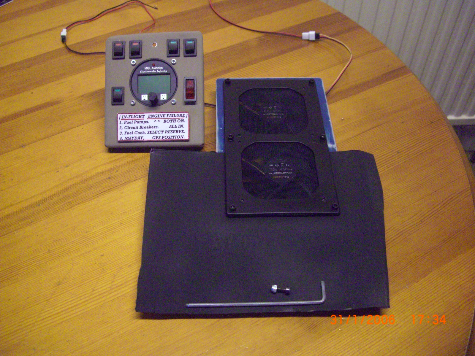

The other bit is my FFM Panel goes in where the gear lever was,
Cardboard denotes skin.

I have had a couple of e-mails asking about cutting the hole in the top of the instrument panel.
I would not like anybody to damage there aircraft so be careful, your hand will rub again the windscreen when cutting and even a small fragment on your skin will mark the perspecs of the screen.
So protect the area with a piece of cardboard , and use a good light to see what you are doing.
use a Tool of you choice, but a simple half hack saw blade will do, rub back and forth will slowly penetrate the surface, once through its cut easy.
Remember to cut with the saw teeth on the pulling stroke,
Remember to keep the blade very shallow angle, as you don't want to cut anything that you can not see on the other side of the panel.
Its easy to do ,just a bit slow,
If you wanted and felt confident you could loosen and move the whole instrument panel forward an inch or two, but I managed without doing this
