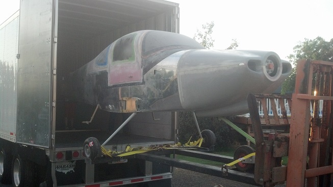

PostPosted: Tue Sep 17, 2013 7:48 pm    Post subject: Re: Flatbed Tow Truck To Hangar Reply with quote
This is how we moved to paint shop for four hour drive. Very secure and easy to move. This skid will be available to anyone to use after it returns back.....only problem is it weighs half as much as complete plane.
 Filesize:  75.44 KB
 Viewed:  21960 Time(s)
Jackm

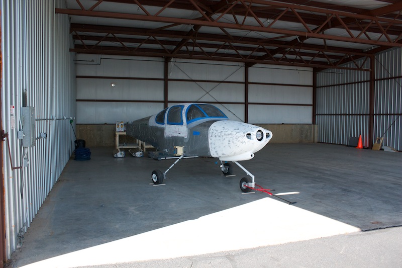

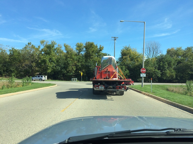

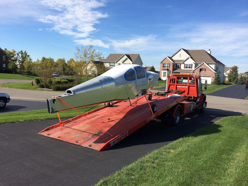

PostPosted: Mon Sep 30, 2013 1:59 pm    Post subject: Re: Flatbed Tow Truck To Hangar Reply with quote
Well it made it safely to its new home. Thanks for all the suggestions. Found a company with a slide down tilt bed so had no issues with the tail dragging. I put bolts through the spars to be used as strap downs. And no... driver was not a wench. Laughing
Funny thing is that I seem to have separation anxiety this afternoon. The baby is no longer a few steps away out in the garage, but a half hour drive.
Jack,
Would you be willing to share any information you have on the design of that skid? Materials, wall thicknesses, etc.
Thanks!
Bill
Jackm
Joined: 23 Jun 2013
Posts: 8
PostPosted: Sun Oct 06, 2013 8:09 pm    Post subject: Re: Flatbed Tow Truck To Hangar Reply with quote
Bill,
Two forklift supports was 3 x 5 x .188" Across rear was 4 x 4 x.188" . Slid in each side was 3.5 x 3.5 x188" tube that was welded to 18" of heavy 8" c chan. Center front was 24" 8" c chan. 1" pipe weld on each rear skid for handles and also round support for straps to pull down on landing gear. Flat bar welded for and aft of each tire to gain extra wedge for tires to ride in.
When I get it back from paint shop I can send you better pictures and dimensions. It took about a hour to weld up and about $300 of metal but I was not going to chance rolling all that work up a ramp and end up upside down during unload at paint shop. This was quick and secure and can be used by others once we are done with it.
Hope this helps and let me know what else you need.
Jackm

Bill Strahan
Joined: 20 Aug 2008
Posts: 145
PostPosted: Wed Oct 09, 2013 2:30 pm    Post subject: Re: Flatbed Tow Truck To Hangar Reply with quote
Perfect! Just hang on ti it, keep a forklift in the hanger, and you can lift it up enough to keep two planes in there!
Jackm wrote:
Bill,
