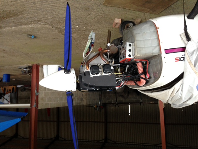

Fred Klein
Joined: 26 Mar 2012
Posts: 503
PostPosted: Tue Oct 01, 2013 7:16 am    Post subject: ULPowered Europa cleared for flight Reply with quote
On Oct 1, 2013, at 2:39 AM, Groups wrote:
<image.jpeg>
<image.jpeg>
Sent from my phone
> On 1 Oct 2013, at 00:11, Pete <peterz(at)zutrasoft.com> wrote:
> Congrats! Pictures please! Smile
Wow...what a sweet, straightforward, and seemingly SIMPLE engine installation...Fred

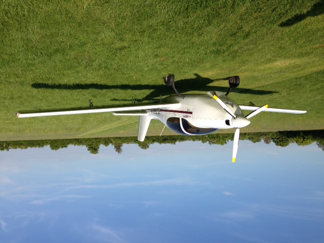

PostPosted: Tue Oct 01, 2013 8:15 am    Post subject: ULPowered Europa cleared for flight Reply with quote
Except that it is upside down. Luckily I have a laptop and I can easily
turn the laptop upside down. With my iPad or cell phone I tried it too,
but it doesn't help as it turns the picture upside down again by itself.
The only solution then is to stand on my head to look at the picture but
I guess I'm becoming too old for this.
Frans
groups(at)thegoddards.com
PostPosted: Tue Oct 01, 2013 10:06 am    Post subject: ULPowered Europa cleared for flight Reply with quote
Try this one
Vince
G-BWUP

rlborger(at)mac.com
PostPosted: Tue Oct 01, 2013 12:37 pm    Post subject: ULPowered Europa cleared for flight Reply with quote
Vince,
Very good looking aircraft. The engine installation looks quite simple and professional.
Can't wait to hear how she flies!
Blue skies & tailwinds,
Bob Borger
PostPosted: Tue Oct 01, 2013 12:46 pm    Post subject: ULPowered Europa cleared for flight Reply with quote
Hello Fred,
Yes a simple air cooled fuel injected 107 bhp engine which takes an hour or so to remove and about the same to refit. Originally I had the engine mounted on the Europa using a 912 compatible mount, this was a little clunky so ULPower produced a dedicated mount which took only half a day to swap over.
Ta
Vince
Sent from my iPad

PostPosted: Tue Oct 01, 2013 1:20 pm    Post subject: ULPowered Europa cleared for flight Reply with quote
Vince...what information can you share regarding your engine's installed weight?...Fred
Ta
Vince
Sent from my iPad
PostPosted: Wed Oct 02, 2013 7:01 am    Post subject: ULPowered Europa cleared for flight Reply with quote
Fred,
The UL260iS comes in at an installed weight of approx 73kg (including all accessories, oil and exhaust). I have the 2x pumps, 2x course filters and 2x fine filters plus the ECU mounted in the mono wheel tunnel, the 2 x ignition, regulator and Oil/Air Separator mounted on the fire wall so leaves about 65kg of engine and 12kg of Woodcomp SR 3000/3J hung on the engine mount. Not sure how this compares with a rotax but looking at the rotax specs and adding the liquids etc I believe the ULPower is lighter.
I did have to hang the Odyssey 680 battery of the pax footwell to get the best CofG.
ta
Vince

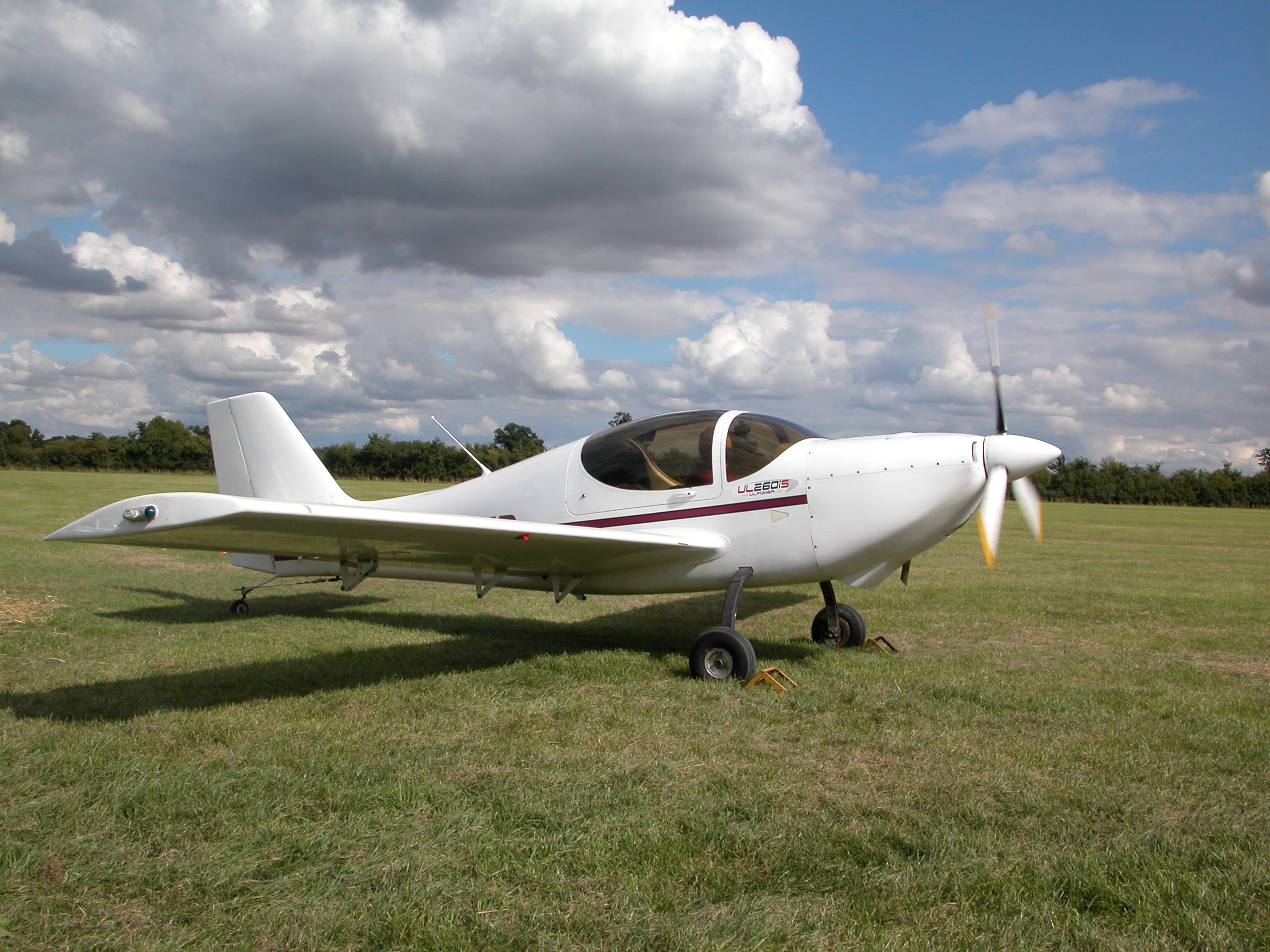

PostPosted: Mon Oct 07, 2013 1:48 pm    Post subject: ULPowered Europa cleared for flight Reply with quote
After some environmental issues on Saturday, BWUP was moved today to Lydeway field (thanks goes to Nigel Charles & LAA for giving permission) and took to the air for the first time in 7 years. Reborn with a ULPower UL260iS engine and Woodcomp variable pitch propellor BWUP had 2 flights totalling 45 minutes. Both flights saw temperatures and pressures within normal limits with no undue vibrations or problems arising. Phil the test pilot commented on how smooth the engine was and removal of the cowls after each flight revealed no issues either. More flights hopefully this week if weather and work commitments allow.
Vince Goddard
G-BWUP
Europa UL260iS Swiss tailwheel

rlborger(at)mac.com
PostPosted: Mon Oct 07, 2013 2:29 pm    Post subject: ULPowered Europa cleared for flight Reply with quote
Vince,
Congratulations to all the good folks involved in the effort. Looks like you have a winner there.
Please keep us posted on the continued testing. We'd like to hear about t/o distance, rate of climb, cruise speeds and fuel flow.
I'd also like to hear how the Swiss tail wheel configuration works out for ground/takeoff/landing handling.
