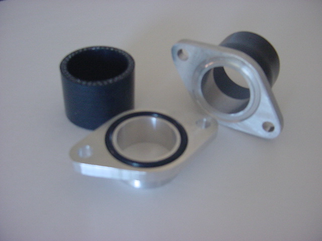

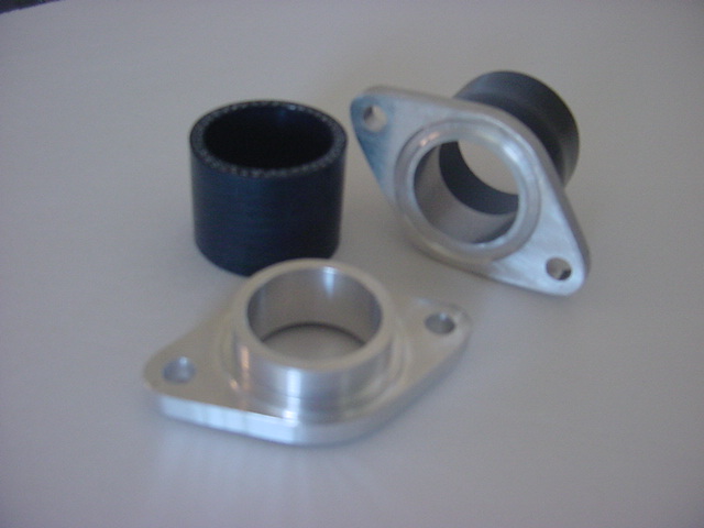

I have been working on a replacement carb mounting flange for the Rotax 912 and 914.
The rotax flanges are known to crack and come off the metal flange. These new flanges
are aluminum flanges tha use a rubber joiner to connect to the carb with two clamps.
All that will ever be needed to be replaced is a $3 rubber. I have a few of these made up
and am looking for someone in the US that is interested in trying a set of these and reporting their
thoughts on them.
If anyone is interested please email me off list to discuss it.

We used to use similar on small motorbikes that had 25mm and 32mm carbs, worked well, the
Original mounts would always break off at the plate end of the tube, changing the tube length
Can allow some "tuning" of the intake as well, but the effect is limited unless you alter the exhaust
Length as well, which in this case would be hard.
