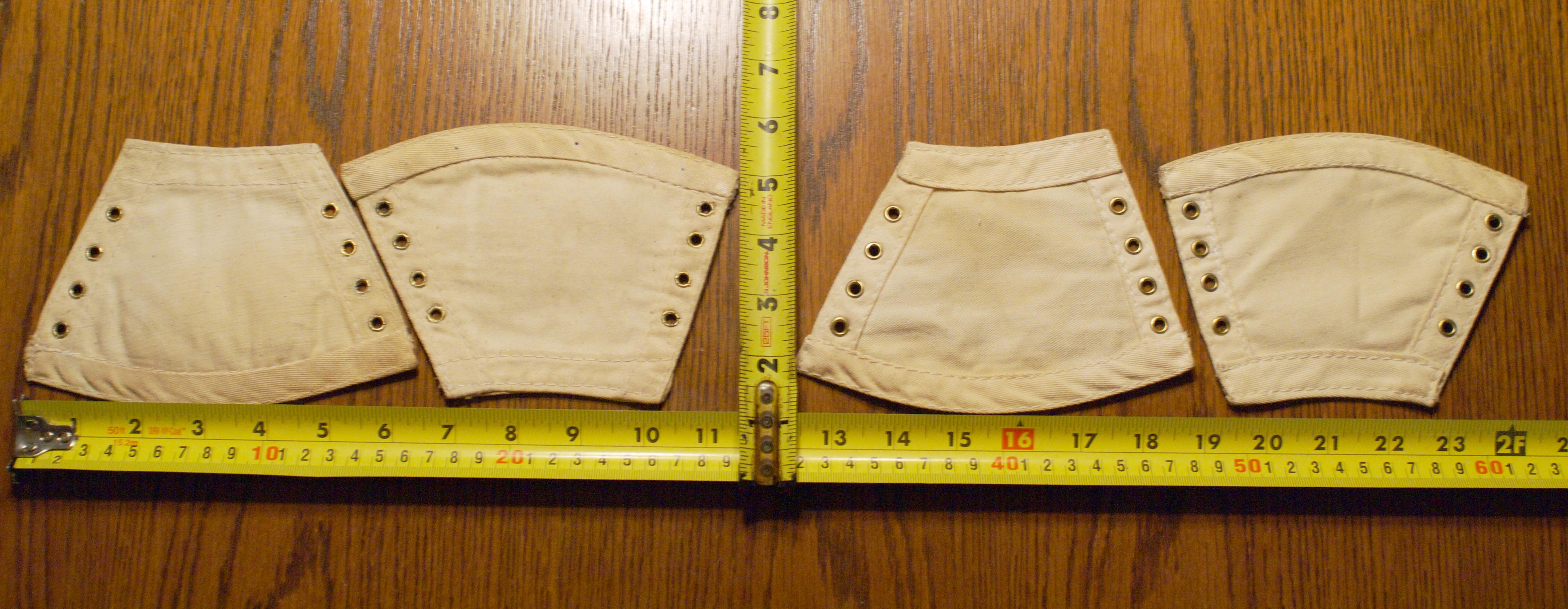

I have a spare set of custom made cloth boots
for my CJ, please see attached picture.
Asking price is US$60 plus shipping and PayPal fees.
If interested, please contact me off list.

Are the boots the same for the control stick, the flap cylinder and the nose cylinder?

I'm assuming those boots are to replace the 4, sticks, flaps, nose strut.
I picture of one installed would be great.
Nice work!
