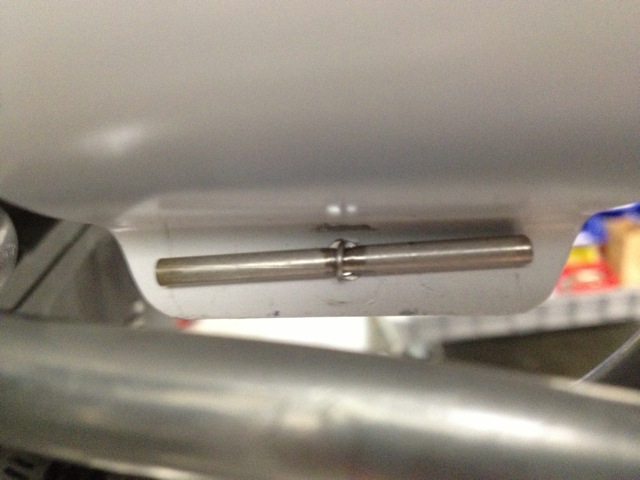

Great photos. I just got through doing the same thing the same way. I
used 1/8" brazing rod spanning the whole 'lip'. Red RTV will keep
things from moving around. I don't think I spent 1/2 hour doing both
sides. I only have a few issues to check off and the engine is ready to
run. The rest of the airplane, however, .......

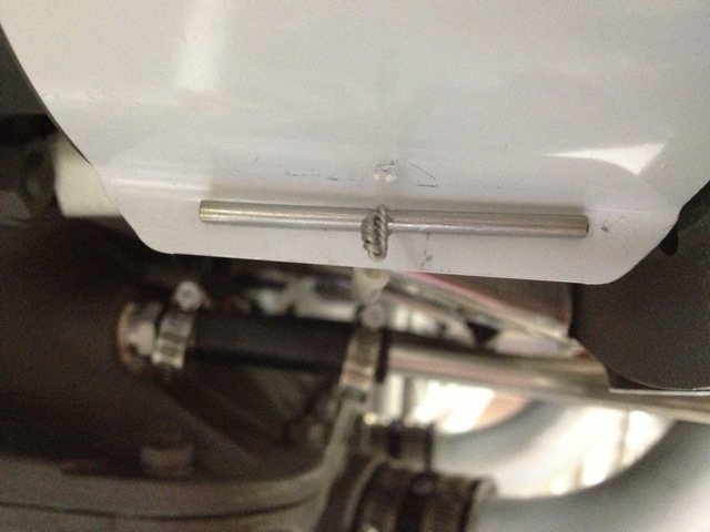

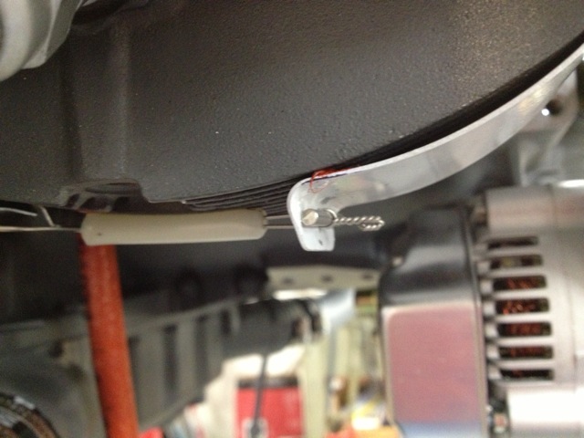

Okay... so here's what I finally wound up with. I feel like this will wear well. Time will tell.
Had I started with this approach I'd probably be finishing up the exhaust system by now... oh well.
