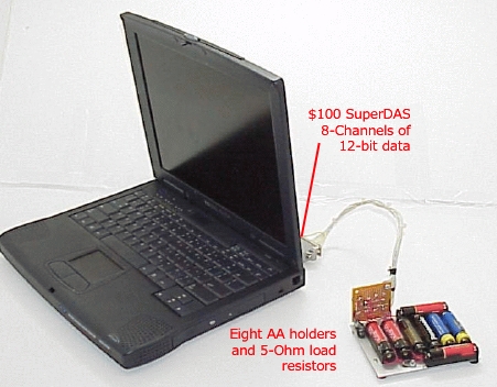

This is a useful comparative test for evaluating
the relative condition of an array of cells . . .
with limitations. It doesn't yield 'baseline' data,
i.e. a quantitative measurement of contained
energy. When I did the first pass at this study
I had a nifty $100, 12-Bit DAS purchased
previously for a Beech flight test program.
Pairing this device with an array of AA cell
holders loaded with 5 ohm resistors allowed me
to run batches of cells down at the same time.
The data yielded was analyzed in software I can't
run under Win7 . . . software that coughed up a
scrip file that plotted results to a graph in
AutoCAD.
[img]cid:.0[/img]
The Phase II test is being accomplished one cell
at a time using a West Mountain Radio battery
tester and its companion software. The earlier
tests were conducted under a constant resistance
load; Phase II is constant current. In both instances,
the analysis yielded a Watt-Hours value for energy
yielded by each cell.
The disadvantage is lack of batch-processing
capability. The advantage is that software supplied
by WMR runs in my more modern computers and also
yields quantitative data.
Still got a soft spot in my heart for that $low$
DAS. It ran under Win95 off the parallel port
of the laptop. It would gather 1000 samples per
second of 12-bit data. In about two weeks of
hammer-n-sawing at the bench, I had fabricated
and installed a pitch-trim study on the Beechjet
that yielded some really nice data . . . along
with foundation for fixing a problem that was
costing the company $millions$.
Those were exciting times . . .
