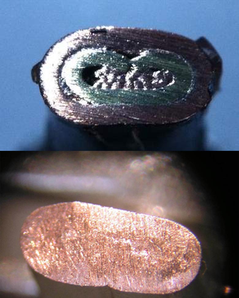

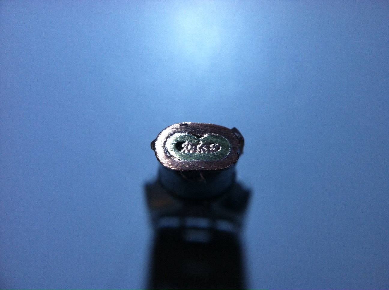

Bob,
Can you tell from the photo if this is this a poor crimp?  It was overheating on the back of a strobe switch.  I recall Bill Watson had a crimp fail on a strobe switch recently as well.  The strobes were occasionally intermittent but the wire near the terminal was always very hot to the touch.  The insulation was discolored too.
I changed the terminal and the last few inches of wire, and now all is well.  Nice and cool.
Any comments on the crimp would be much appreciated.
Dave Saylor
831-750-0284 CL

I think the evidence is pretty conclusive. ANY terminal that gets hot is victim to heat dissipated in some resistance between wire and terminal or terminal and installation surface . . . or both.
Compare the appearance of cross section for the terminal you replaces versus a terminal I sectioned for this article:
http://tinyurl.com/kfk6jss
The terminal you removed was definitely not INTIMATELY mated with the wire strands. There are voids between strands and a large void in the cavity adjacent to captured strands. In the "golden-crush", wires become indistinguishable from the terminal's wire grip barrel.
Was the terminal the right size for the wire? If it was installed with a tool from your shop, an investigation is warranted. You don't want to install a bunch of terminals like that!
