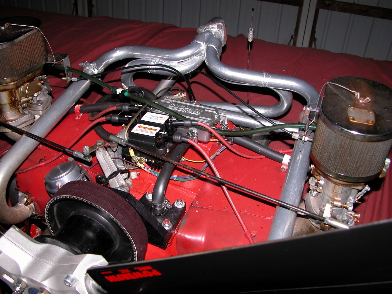

Does anyone have an "oil separator" on their MKIIIC or MKIIIX? Where do you have it mounted?

I used a Bug Pack oil separator. The big VWs need to breathe or they will push oil out everywhere. This unit connects to the redrive breather and both valve covers. I mounted it  high on the engine so residual oil drains back into the engine. I fabricated a mounting strap that I bolted to the flange next to the flywheel then bolted the oil separator to that strap. See the attached photo.
