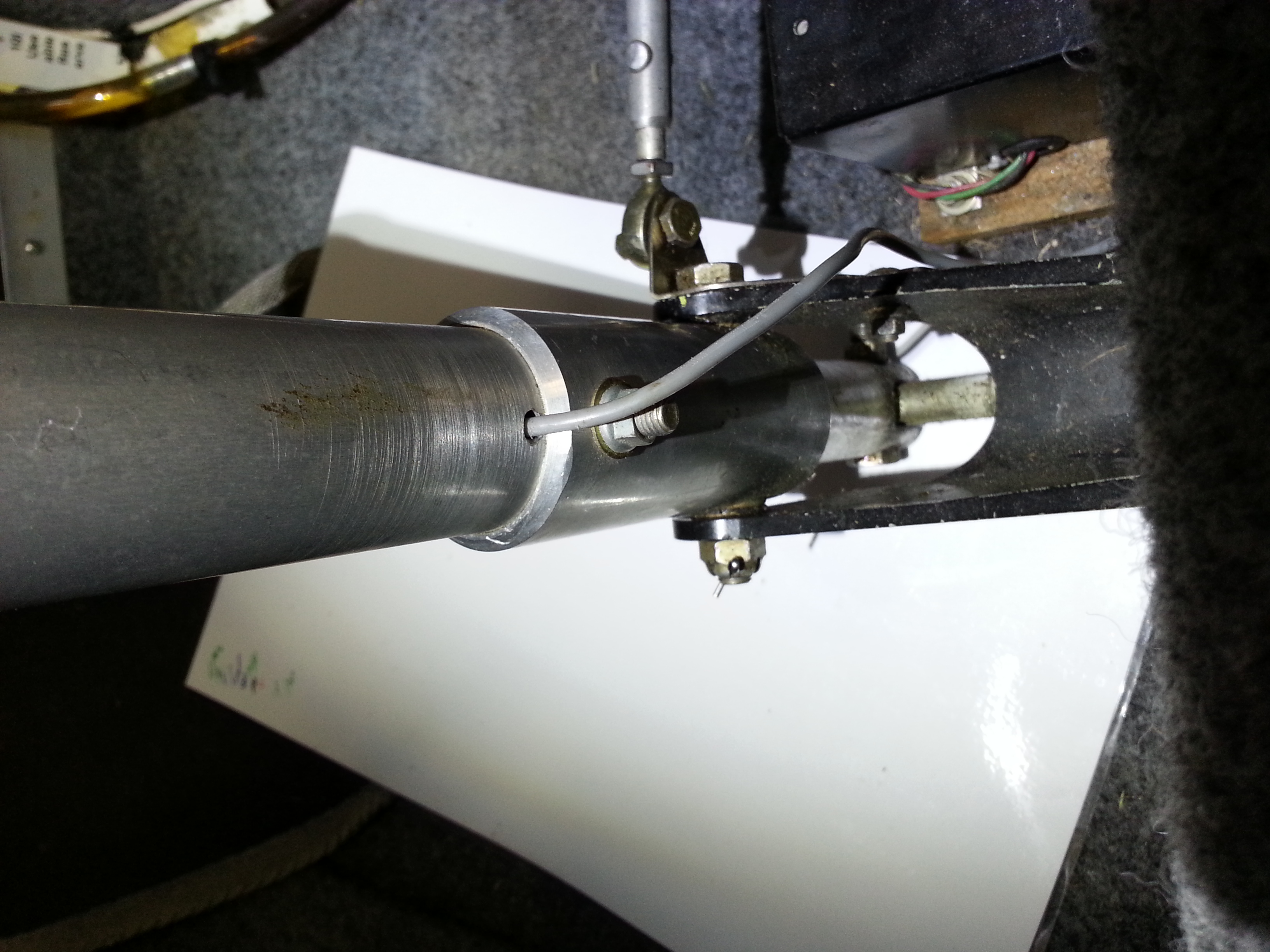

Ok, nearly there with getting all the parts together to complete the Navaid wing leveller installation.
Would anyone know the parent numbers & where to purchase the constituent parts that make up the 'push rod' that connects the servo to the aircraft? I can see from photos, that its a length of tubing, rod ends & very small rose joints; but my head hurts from trying to track down all the correct numbers Sad

LAS Aerospace Ltd (Light Aero Spares) would be my first port of call - they
should stock everything you require.
http://www.lasaero.com
What you need will depend on the how you are installing it - I am not aware
of any standard installation.
Here is a quick pic of ours which I designed myself (sorry, not the full
installation - this was a shot of the stick which shows where the servo arm
is connected). It is a short length of tube and two rod ends bolted to a
bracket at the base of the control stick.
Hope this helps.
