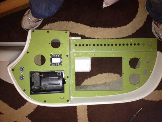

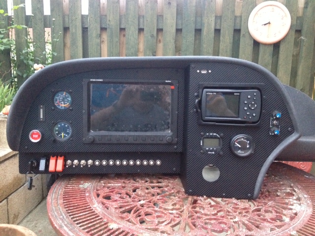

Hi
I went down the route of aluminium sub panels screwed into anchor nuts which were riveted onto a 15mm edge all the way around my panel cut outs. Below is photo of my panel with the sub panels cut out and mounted, then another one with the completed panel with instruments installed.
This set up is very easy to remove if required for maintenance just undo securing screws and panel pulls out giving plenty of access to work in behind panel.
