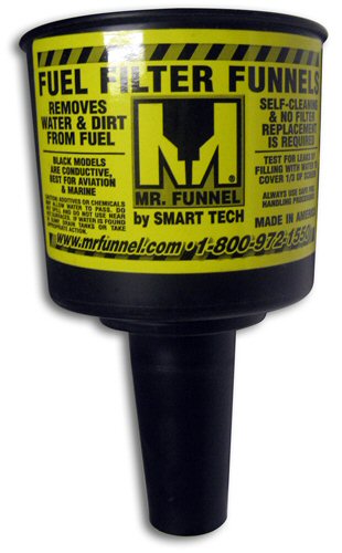

I wonder what kind of practical size for a FUEL FILETR FUNNEL have proven
to be most suitable for the Europa? From your comments it appears more
practical to rather pre-filter mogas at the filling station into the clean
fuel containers rather than sticking a filter into the fuel fill opening
on the EUROPA SX style on the side.
More specifically, Aircraft Spruce has 3 models, small, middle and large
with 2.5,3.5 and 5 rpm throughput, but significant size differences. Which
one would you recommend? I am filling up my AC first time this weekŠ
Christoph Both

Christoph,
what bigger that better in this action.
If small, you will loose your nerves - it is so
slow. Refueling speed is also safety issue - less
time to get debris from there and there!
There is also a model with double outport.
I have one large w 2 ports when using home and
carry small one w 1 port in the ac when flying
far.
Yes - It is very unpractical to use it when
filling XS. Use it when filling your canister. In
that way you can filter it 2nd time if necessary.
When filling direct to your ac it´s too late and
one time operation.
Good luck,
Raimo

I agree with Ramio - the bigger, the better. We have the largest size
available (about 8" in diameter at a guess) and we still have to pour slowly
to avoid an overspill.
IMHO it is pointless filtering the fuel going into your fuel cans as the
internal paint (metal cans) has a tendency to flake off. It should be
filtered from the refuelling can or pump when going into the aircraft. Easy
for me to say as we have the old style filling system (located on top).
Not sure how this works if you have the newer side filling system - thinks
you may need to rig a sling to support the funnel on the side of the
fuselage with a length of poly tubing extending into the filler. I'm sure
other Europa owners have cracked this problem.
It is worth mentioning that the fuel cans need to be earthed wherever
possible - not so much of a problem with metal cans.
I believe one Europa was lost to fire when a spark from can to filler
ignited the fuel. I think if you buy an aviation specific funnel (ie: Mr
Funnel) it will be made from conductive material but you would lose this
benefit if you extend the pipe with poly tubing. However it is relatively
easy to earth the filler opening with your finger and then ensure you do the
same with fuel can before commencing the fill.
I think the problem with static is generally associated with plastic cans -
perhaps someone with better knowledge on this issue could comment.

We are fortunate in that all our fuel is from cans which we insist on
filtering through a fine mesh funnel and we have never found any signs
of a clogged filter. It is worth noting that metal fuel cans generate
their own debris as the internal paint on the cans tends to flake off
and if not filtered would cause problems if not pre filtered.
