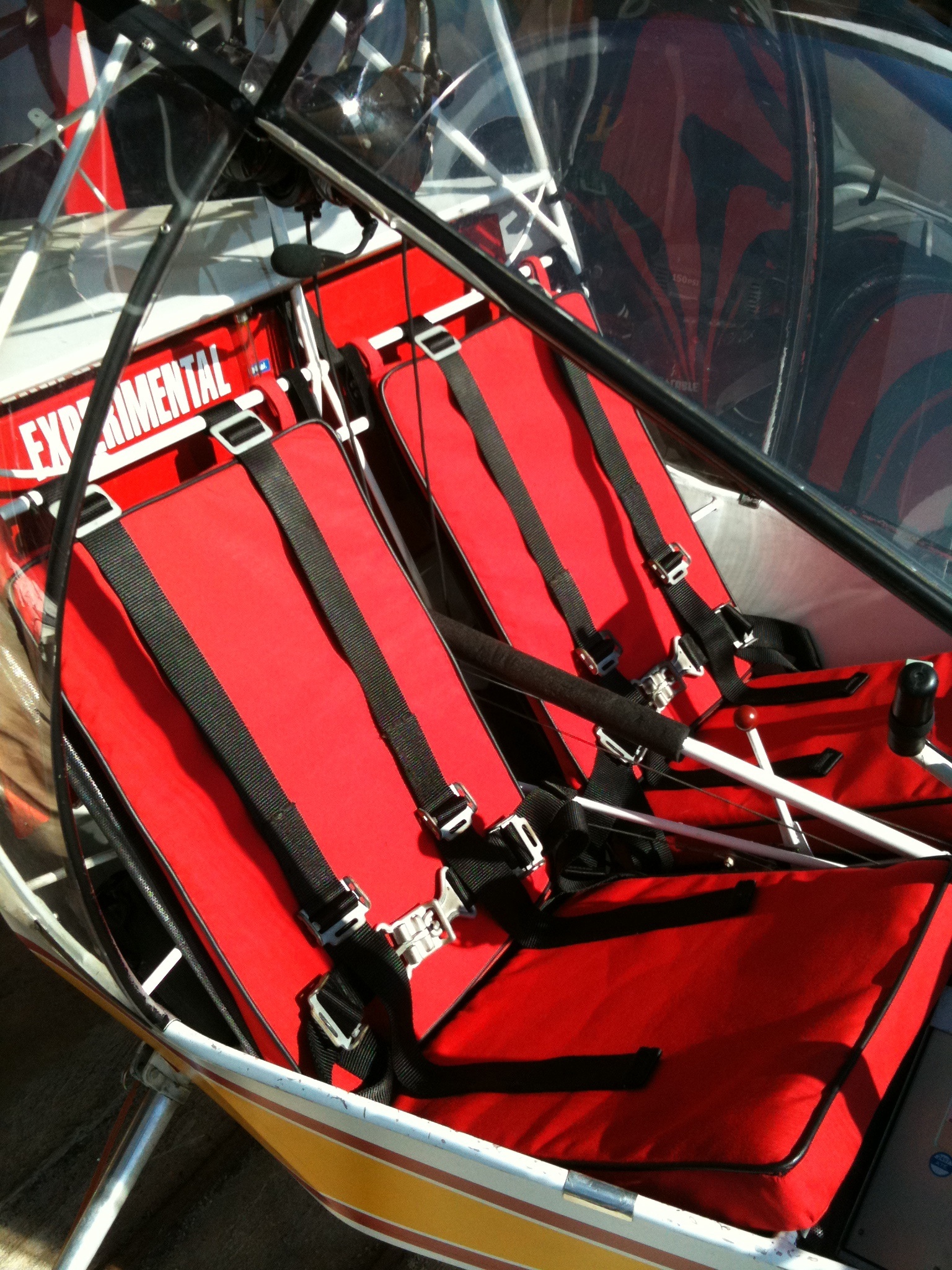

Does anyone have pictures of the upholstery package in a
Mark III? Also what exactly is included. The sling style
seats need to be replaced in mine. After a few hours of
removing fabric yesterday I was sitting in my plane making
airplane noises when it occurred to me how uncomfortable it
was, especially the bottom. I know I could use a cushion
but I want a "professional" look when I'm done.

I have talked to Travis. I was hoping to see some different pics though.

I bought some sunbrella, uv resistant canvas used for boat cushions and some "piping" and took it to a professional seamstress. I also bought some 2-inch "memory foam."
Here is the result on my MkIII sling seats.
