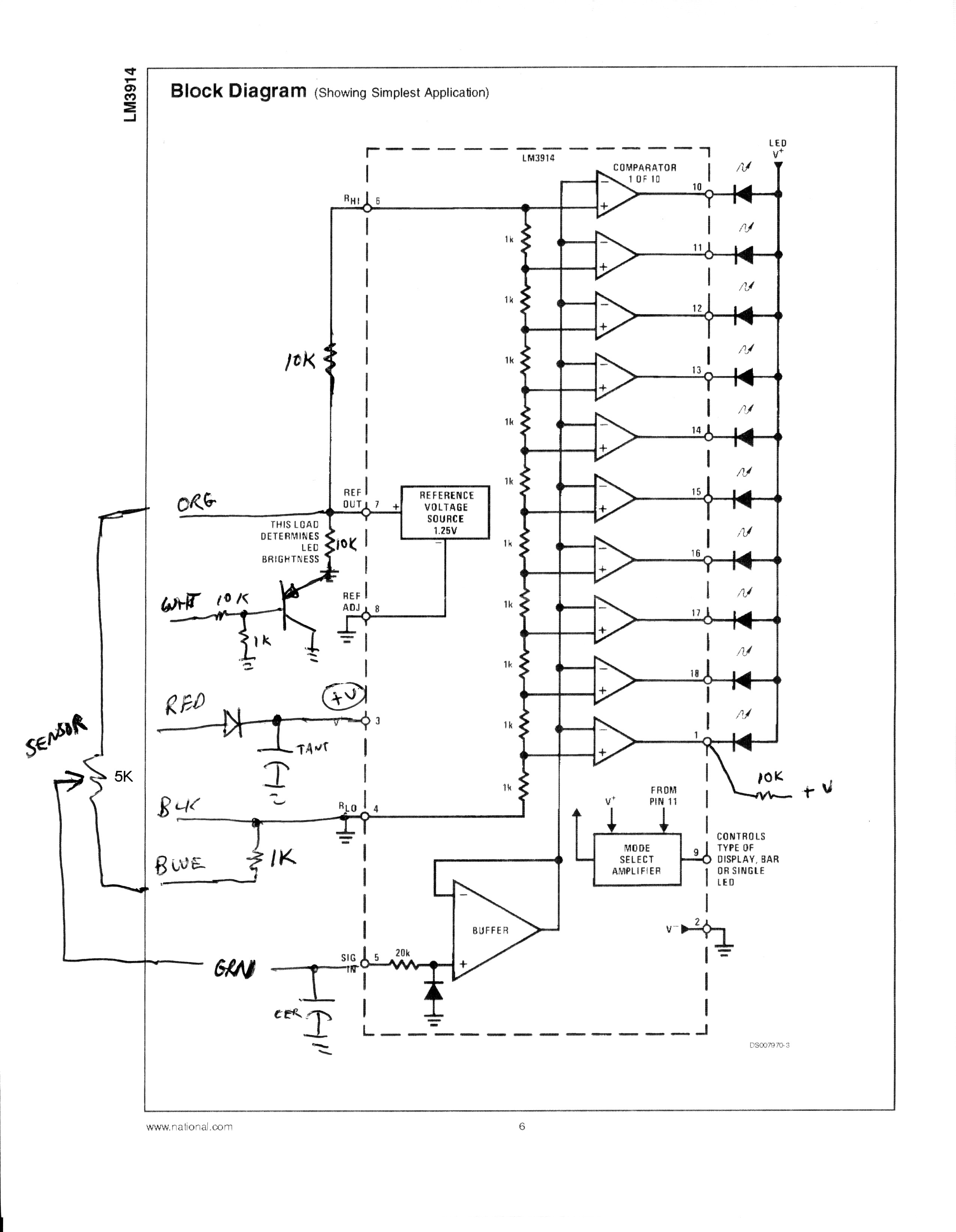

Bob a while back you drew up a ckt to drive two RAC RP3 indicaters from one
servo output. Cant find it. And could you add the component values to the
ckt drawing. Thanks Bill S.
from one servo output. Cant find it. And could you add the
component values to the ckt drawing. Thanks Bill S.
I don't recall the specific posting but the
solutions are simple. During discussions
about the RayAllen products on the List,
the operating voltage the position reporting
potentiometer in the actuator was reported . . .
I don't recall if it was 5 or 12v.
Can someone on the List cite the actual value?
Also, I'm guessing that the ORN wire out of
the indicator is the excitation voltage for
the pot, the GRN wire is the pot wiper and
the BLU wire is ground . . . yes?

The operating voltage of the indicator is 5v and the wiring colors you state
are correct.

Attached is a crude schematic of the Ray Allen indicator.
As you can see your colors listed are correct.
Dick Tasker
