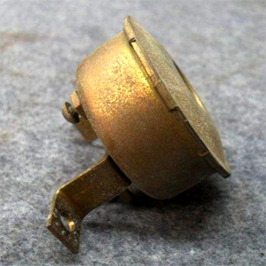

HHHmmmm. . . . I think the PSE guys missed the boat on
this one. An ELECTROMECHANICAL horn is an enhanced buzzer
with a diaphragm added for greater sound output. This
is an exemplar horn used on MANY thousands of S.E. aircraft.
The warning tones for this style of horn cannot be electrically
'mixed' into the signals that drive your overhead speakers.
[img]cid:.0[/img]

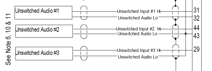

The installation manual wiring diagrams show "unswitched audio
inputs . . .

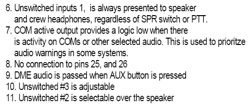

. . . with references to notes 6, 10, 11 . . .
[img]cid:.2[/img]
From this data I deduce that input #1 is always ported
to both speakers (if connected) and headset audio
irrespective of condition for any system controls.

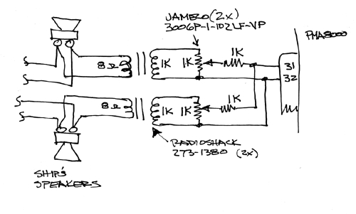

Consider this interface circuit for tapping your speaker
wiring and routing through isolation transformers
to eliminate all possibilities for ground loops and/or
unanticipated sneak paths. Two potentiometers will
allow you to adjust the volume of each tone independently
before they are mixed and applied to US-Input #1.
[img]cid:.3[/img]
You can try single-turn pots if you like but I think
the multi-turn, screwdriver adjust will provide a more
vernier command of the audio levels and will 'stay put'
with time.
