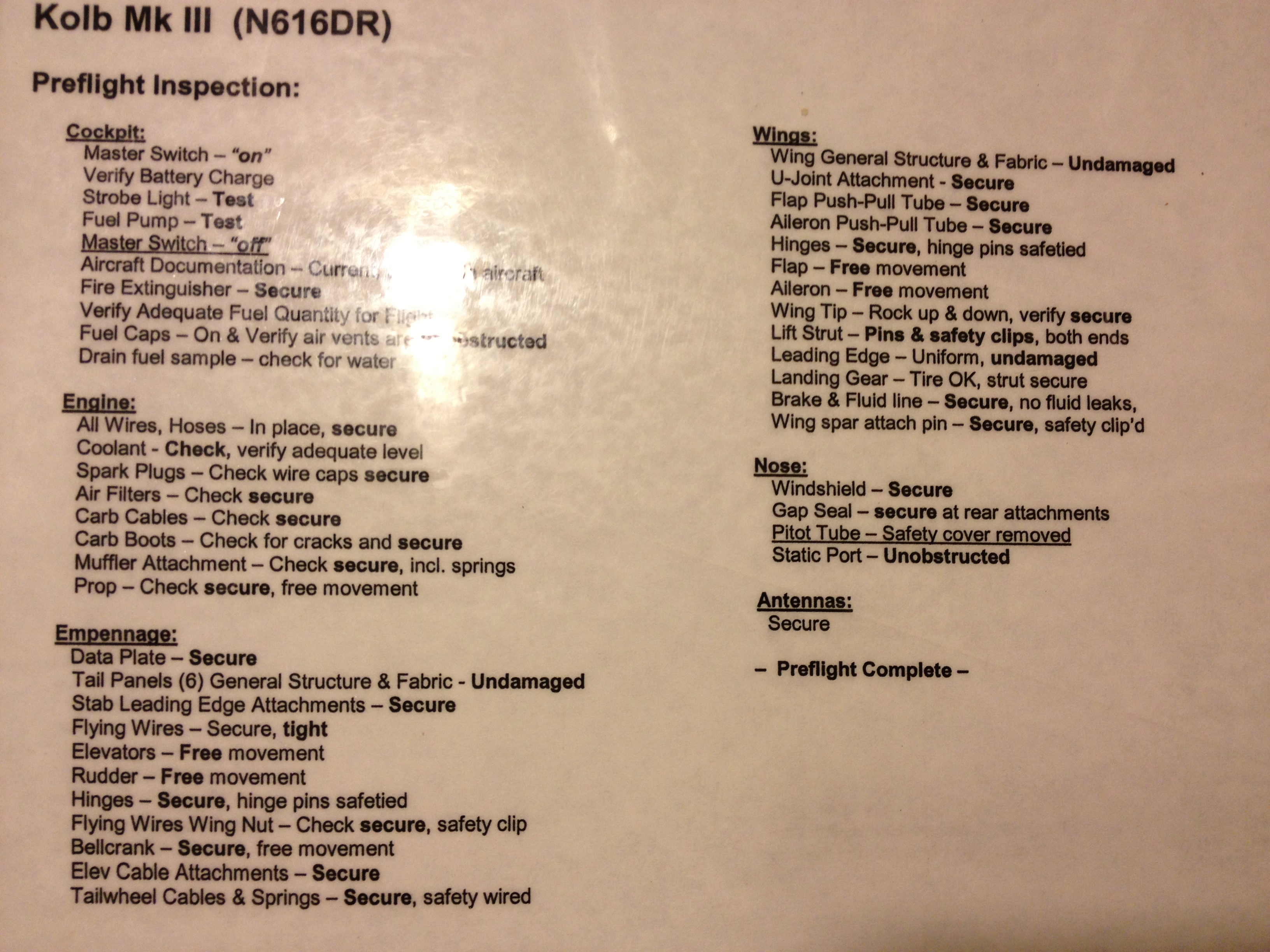

PostPosted: Fri Aug 23, 2013 5:40 pm    Post subject: Mk-3 POH part 2 Reply with quote
Dennis "Skid" Rowe
Mk3, 690L-70, Leechburg, PA

PostPosted: Sat Aug 24, 2013 7:31 am    Post subject: Mk-3 POH part 2 Reply with quote
GREAT check list .../ SOP flight procedure ... is it for a 912 ????

PostPosted: Sat Aug 24, 2013 10:28 am    Post subject: Mk-3 POH part 2 Reply with quote
No,
It's for a 2si 690L-70 two stroke triple.
