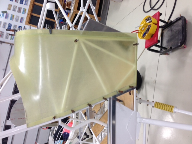

I could not find in the directions how to attach the boot cowl. I don't really see a need to ever remove it other than ease of access to the front side of the IP.
Screws wouldn't look as nice as hysol and riveting in place. I'm just wondering what others have done.
-Mike Kraus

Hi Michael. Don't kid yourself that you wont want to remove it. I have a
booted cowl on my Avid that is held around the bottom of the windscreen with
machine screws and captive nuts about 3 1/2 inches apart, and camlocks
everywhere else. I have had it off numerous times, to install and service
a transponder, to change a dud radio, to change EGT's that stopped working,
and to take the engine out to replace the water pump. (Rotax 912) Don't
rivet it or you will certainly regret it.

I think I would have to agree with Brian. I have helped with or built 3
Kitfoxes and one Lancair. Being able to access the area behind the panel
without laying on your back with your head against the rudder pedals is like
heaven compared with the Lancair. On that, I helped build the panel and
get it physically in the airplane, but when it came to wiring everything
together, I backed away - my old body would probably still be stuck in there
somewhere. But, the proof would be to attach the cowl, imagine every corner
of the panel, especially with radios, displays and other items extending
forward with switches, mounting hardware, and pneumatic tubing and see what
you can reach.
One other option might be to design a modular panel with sub panels that are
removable which can be assembled on your lap and then stuffed and screwed in
place.
Lowell
