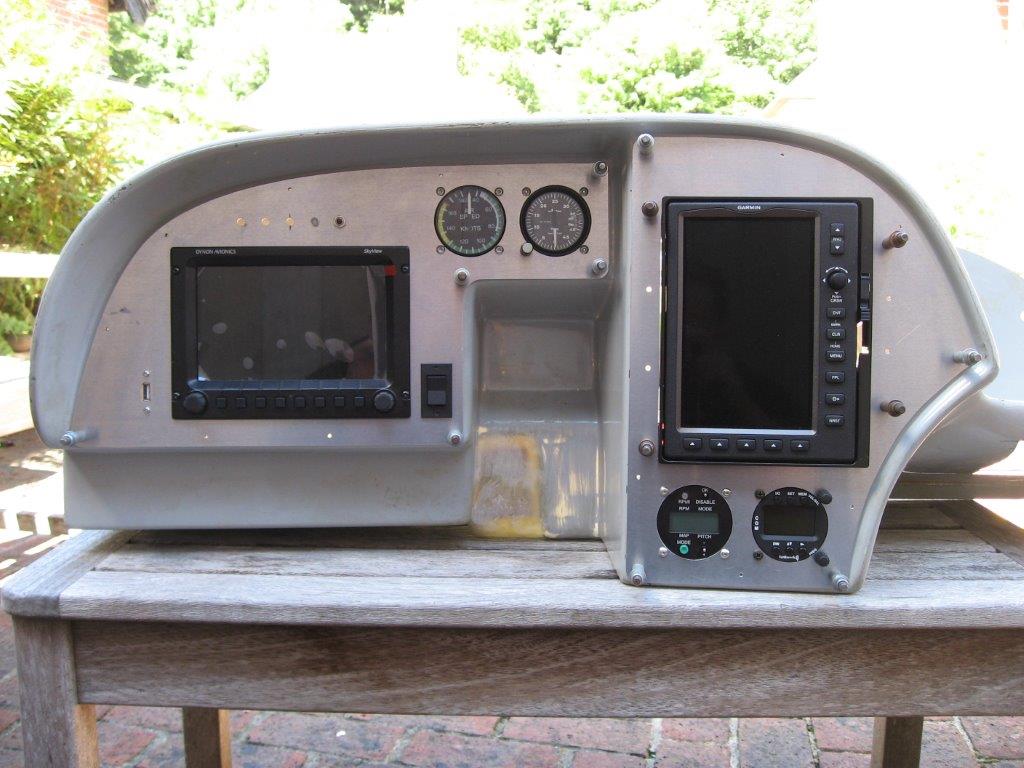

What paint finish and manufacturer have others found successful?
I am thinking mid grey for the main fibreglass and a lighter grey for the aluminium sub-panels (factory-supplied). Anodising turns out brown on this alloy, otherwise I'd have done that.
I hear that satin is a good finish (gloss is too reflective and matt gathers dust and greasy fingermarks, so soon looks patchy and ugly - a bit like me...)
Obviously I need a UV-resistant paint and Plasti-kote make a good range, their Super being well-recommended. Only problem is they do a light grey satin and a black satin... the only mid grey is gloss or matt.
Have others found any problem with black as a main panel colour, or with matt as a finish texture?
So, choices.... the best finish (satin) in the "wrong" colour (black) or the best colour (grey) on the "wrong" finish (matt)?
Grateful for any answers.
Photo of panel so far, if it helps to picture the problem...

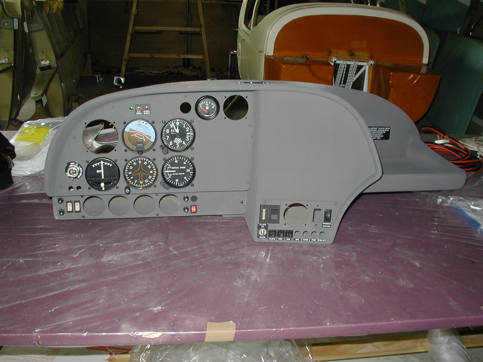

Hi Paul,
I had my panel sprayed by Mtthew Russell using "nextel" a
lovely non reflective finish. many colour available and not that
expensive Smile . pic attached.
cheers Danny. G-c.e.r.i

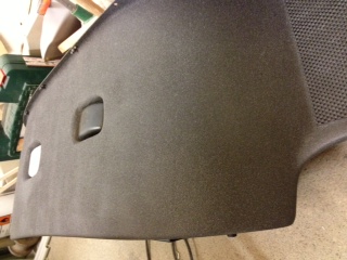

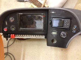

Hi
I have just recently painted my panel with rust-oleum textured spray paint and covered the aluminium sub panels with a carbon fibre wrap.
I have attached a couple of pictures showing my panel.
Kind regards
Donald

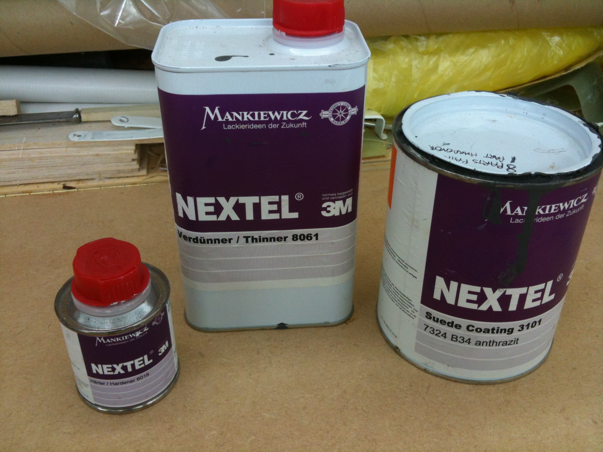

Hey Paul,
I have about 0.5l of the grey and more importantly a qty of liquid hardener and some thinners - see pic
The tricky bit is how to get it to you as being solvent based paint the RM are cagey about posting it.
Any good to you?
Clive Sutton
G-TAGR kit 341

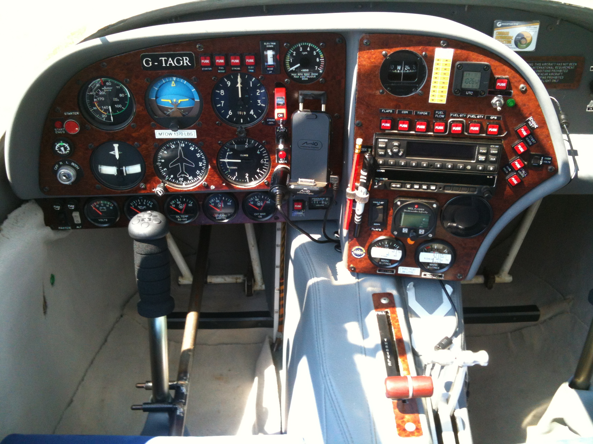

PostPosted: Thu Aug 22, 2013 10:34 am    Post subject: Re: Panel Paint Reply with quote
PS; the UK supplier at the time was Mankiewicz UK in Leicester:
Unit 26, Ashville Way, Whetstone, LE8 6NU 0116 284 7780.
Not sure if they are still around but if you prefer a different colour from the 'anthacite' I have, its worth trying to call them.
I can recommend it - looks good, does not seem to show any fingermarks, and does not reflect sunlight in the air.
A pic of my panel attached btw
Clive
