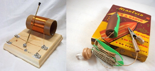

It has been readily demonstrated that an artfully
crafted 'crystal set' can perform rather well and receive
even overseas short wave broadcasts. The kind of performance
was never demonstrated in the typical crystal set kits and/or
merit badge construction projects.
[img]cid:.0[/img]

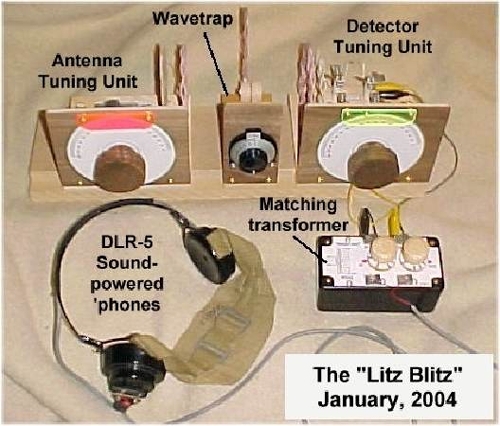

If one is into SERIOUS crystal radio fabrication for optimized
performance, the lowly battery-less radio is likely to appear
more like this . . .
[img]cid:.1[/img]
Separate tuners and traps wound with Litz wire, Schottky detectors,
and matching transformer to optimize coupling of energy to the
headphones. The radio above was a Dx contest winner for the
builder.
