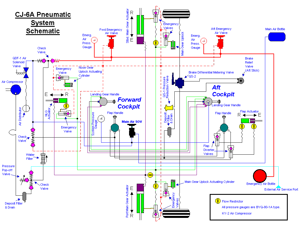

Attached are two schematics. One is from the CJ manual. One is an incredibly well done color coordinated version.
It seems to me the restrictor labeled #40 on the CJ manual drawing is in a different location (nose gear side) than the restrictor located on the color version (rear gear handle side)
Anyone know which is correct?

PostPosted: Wed Aug 14, 2013 6:53 am    Post subject: CJ pneumatic system Reply with quote
Hi Keith,
thank you very much for posting
this masterpiece of drawing,
kudos to the author.
cheers
Elmar

PostPosted: Wed Aug 14, 2013 7:45 am    Post subject: Re: CJ pneumatic system Reply with quote
I wish I knew who to give credit to!! And selfishly hope he does one for the electrical and fuel system!!!!
