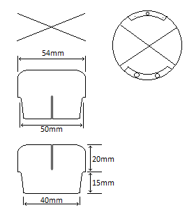

I was running 255 main / 290 needle until recently, my EGT's were kinda on the high side. Then I placed the recently much-discussed 'X' (on Yahoo) in my carby inlet, hoping it would straiten the airflow.
It sure made a difference.. EGT's dropped to waaay too rich. I'm now on 250 main / 280 needle and EGT's are still richer than they were before. Perhaps it will do the same for you.
I'm attaching the drawing of my 'X' baffle, hope Matronics relays it. If not, you can find it in the Yahoo file section
Rob

naftalih(at)hotmail.com
PostPosted: Thu Sep 05, 2013 12:26 am    Post subject: EGT Reply with quote
Hi Rob,
How did you install the X?
Friction, adhesive?
Any fuel saving?
Kind regards,
Naftali.

matronics(at)rtist.nl
PostPosted: Thu Sep 05, 2013 2:29 am    Post subject: EGT Reply with quote
Hi Naftali,
I made the X out of thin brass sheet. Two slits make it fit together, then I soldered it through. The shape width is such that the top of the 'mushroom' sits on the rim of the carb. In addition I soldered small tabs on the outside of the mushroom (not on my drawing) which clamp on the outside of the carb rim. The SCAT tube slides over these tabs and the clamp keeps everything neatly in place.
Too early to tell if I have significant fuel savings. The engine behaves different, using 18l/hr at 2500rpm, but going up to 25l/hr as soon as I pass 2700rpm. It used to be 19-21 l/hr anywhere between 2500 and 2700rpm. I still need to find the ideal needle/jet combination for this new situation.
Rob
PostPosted: Thu Sep 05, 2013 8:17 am    Post subject: EGT Reply with quote
Thanks Rob
