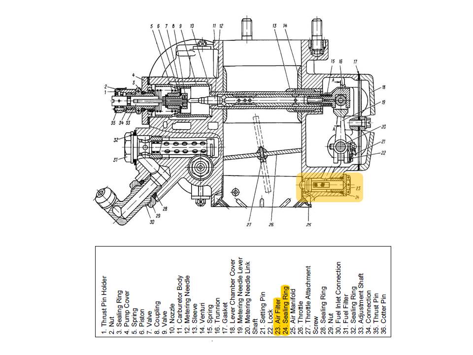

Rob Rowe
Posts: 124
Location: Berkshire, UK
PostPosted: Thu Sep 29, 2016 4:50 am    Post subject: Re: [Non-DoD Source] Re: M14P running very rich at idle, st Reply with quote
You might also want to check the idle air filter to see if this is obstructed too.
Located as per image ...
Rob R
AK50 Carb - Air Filter
