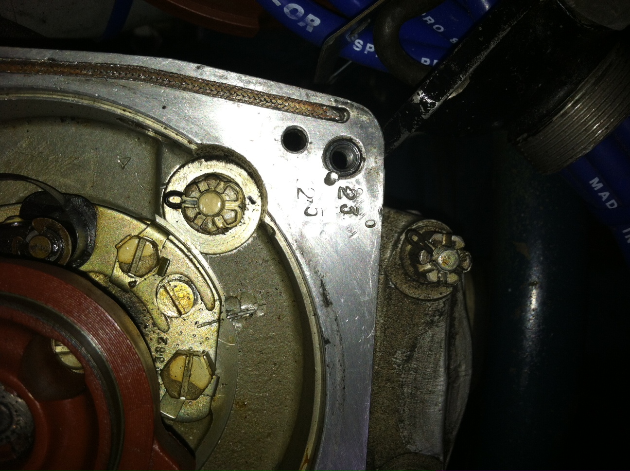

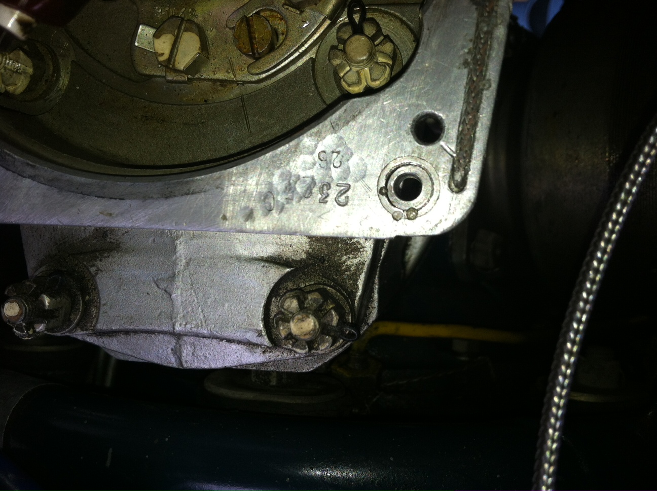

PostPosted: Tue Aug 06, 2013 12:57 pm    Post subject: CJ Mag question Reply with quote
The two photos attached are of my left and right mags and the timing number stamped on them. I believe 23 to be the correct number although the other number on each mag looks prominent but in an area that looks like it may have been ground down.
Comments?

PostPosted: Tue Aug 06, 2013 1:58 pm    Post subject: CJ Mag question Reply with quote
Keith,
Nothing attached.
Dennis

PostPosted: Tue Aug 06, 2013 4:51 pm    Post subject: Re: CJ Mag question Reply with quote
that's weird, I can see the pics on the post.....I'll email them, but I hope they show so others can have a look too. Links are below:
K
http://forums.matronics.com//files/left_mag_156.jpg
http://forums.matronics.com//files/right_mag_508.jpg

PostPosted: Tue Aug 06, 2013 9:53 pm    Post subject: CJ Mag question Reply with quote
Keith;
I would suspect that 23 degs. is the correct number. That could change at
overhaul of the mag. depending on the spring tension, etc. of the new
auto-advance parts installed. The original 25 deg. markings should have
been obliterated to avoid confusion.

PostPosted: Wed Aug 07, 2013 6:39 am    Post subject: Re: CJ Mag question Reply with quote
Thanks Walt and Dennis!
