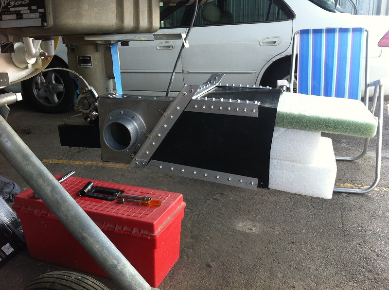

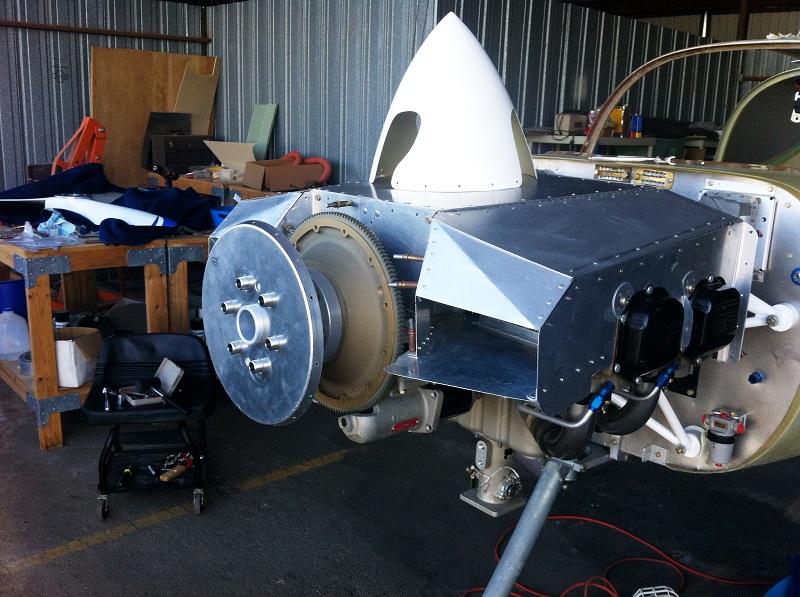

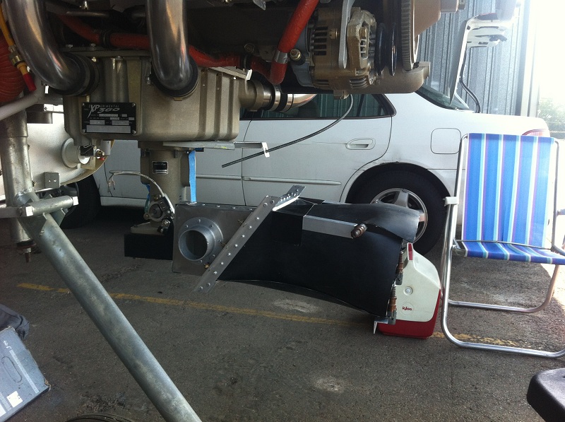

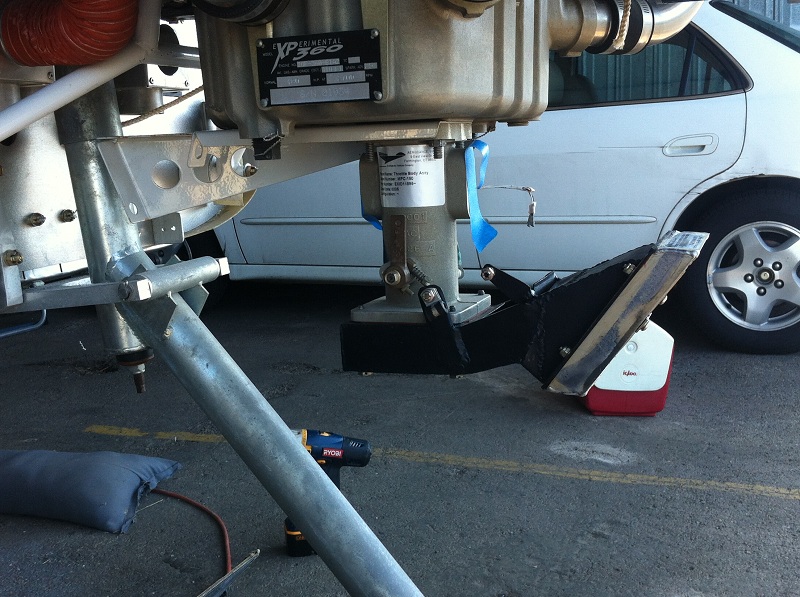

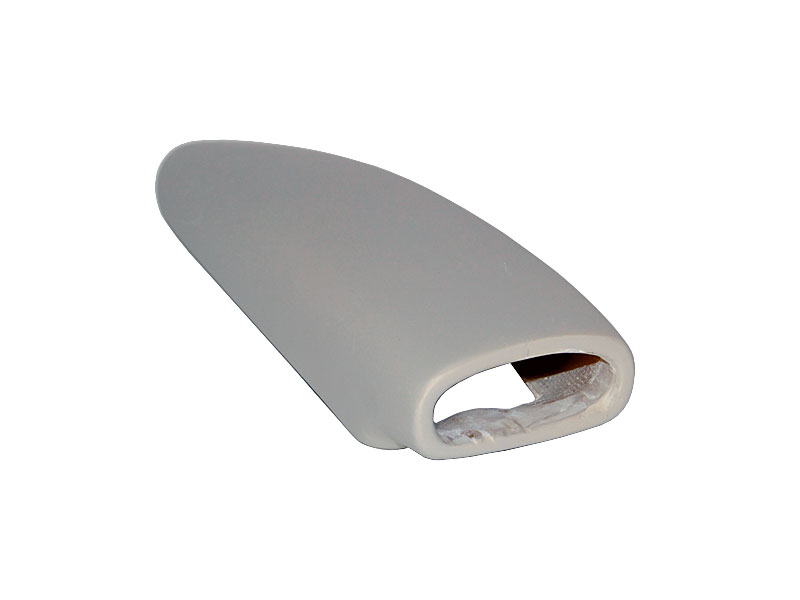

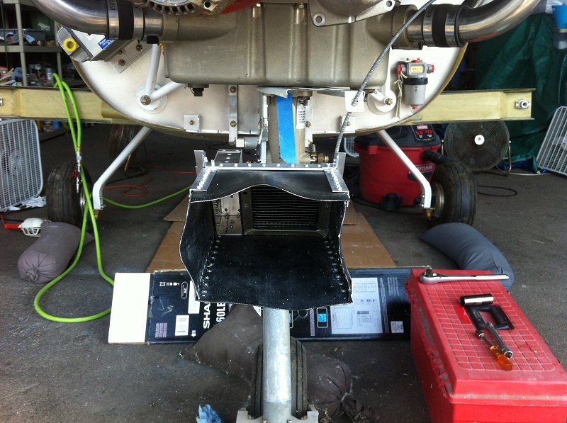

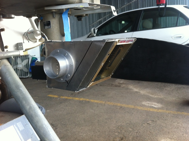

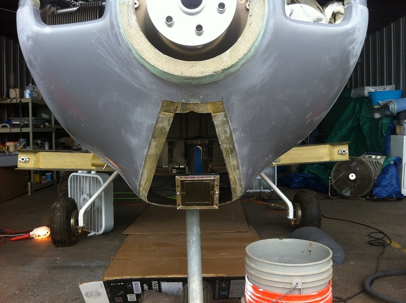

I never noticed that the throttle body on my aircraft was NOT Centered under the engine and was a full two inches taller than a normal throttle body. As a result the NACA inlet that I carefully centered in the cowling was NOT going to work. I found an air box on EBAY for the Lycoming 360 engine with alternate air and filter which was as close as I was going to find without a total custom fabrication. I paid a grand total of $45 dollars including shipping. Not a bad price.
The problem was that it stuck down way too low and was too far to the pilot side to fit with the NACA inlet. The top of the filter unit was to high as well. I had looked at numerous other options and all of them was going to require a redesign of the cowling so the fun begins. First I cut out a full section of the lower cowling for a removable panel. The throttle body/air box was offset a full 1 1/2 inches. First thought was to just reshape int inlet area and connect to the air box. I knew that I was going to have to fabricate some sort of baffle to connect to the cowling air scoop so I started trying to fabricate an attachment.
I have also been trying to find a good place for the air inlet for a hose connection to the heat muff for cabin heat. Then came the little light bulb of an idea. Why not use that extra 1 1/2 inches to fabricate a simple little box for the air outlet? Simple is obviously a relative term and after 2 1/2 days of 100 degree heat I have just about finished that simple little box. The baffle opening to the air box will be shaped to slide in the air scoop outlet and form a seal without having to use a screw connection. I will complete the air box inlet and the shape the air scoop to fit snug.
What made the "simple" little box take so long? First was trying to fabricate it around the existing air box and filter with a baffle seal that could be removed for access to the filter. It needed to attach to the existing attachment for the filter and keep the seal. Finally, the whole thing was built with just flat stock and off the shelf aluminum stock using hand tools without a metal brake.
NO PROBLEM….Right?
The attached photos show the purchased air box attached to the throttle body. The second photo shows the butchering of the inlet to get the lower cowling on. The next photo shows the lower panel removed with the cowling installed. You can easily see the offset and how low the filter sets. The last two photos show the cabin heat source box attachment and the last photo shows the baffle material in place and ready to be cut, riveted and trimmed. The challenge was keeping everything tight for a good seal while making it removable for access to the filter. Looks like it’s going to work but still have a couple of more days work to fit the cowling and fabricate the air scoop.
I will put up more photos of the completion. If I ever get it complete!!!!

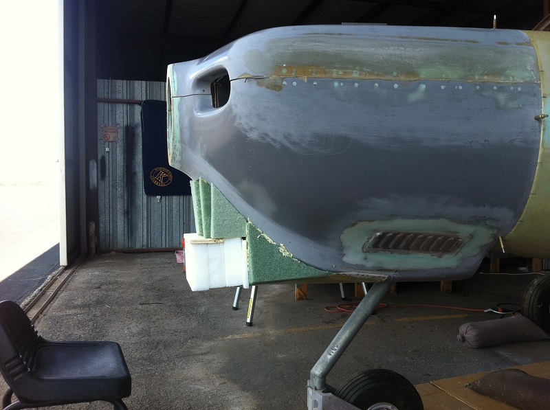

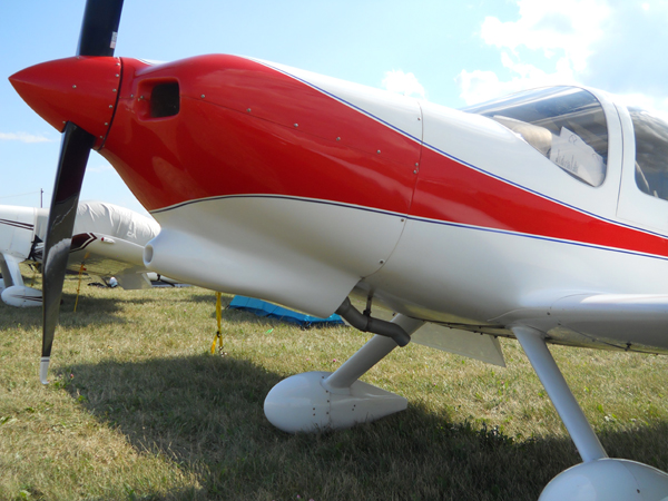

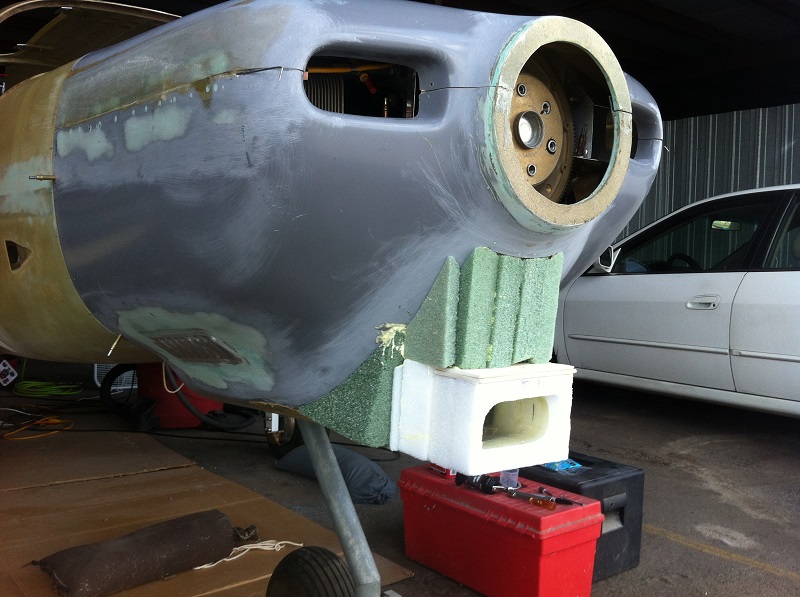

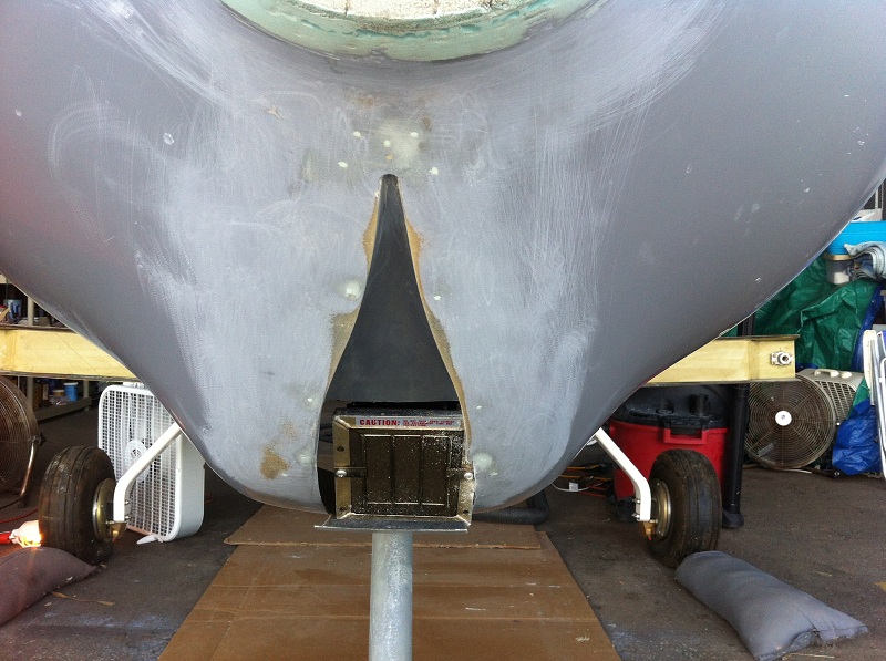

Well, the air inlet box is finally finished and I can move on to the air scoop and cowling modifications. What a day, the recorded temperature at the airport was 102 with a feels like of 108 degrees. I would beg to argue, it felt more like 120 degrees to me. The forcast for tomorrow is 104 with a feels like of 110 to 112 degrees.. See the photos for the final air box. It is setup to wedge the air scoop inlet into the air box opening and produce a seal. The baffle section is connected only by the baffle material and the baffle section if easily removed for access to the filter.

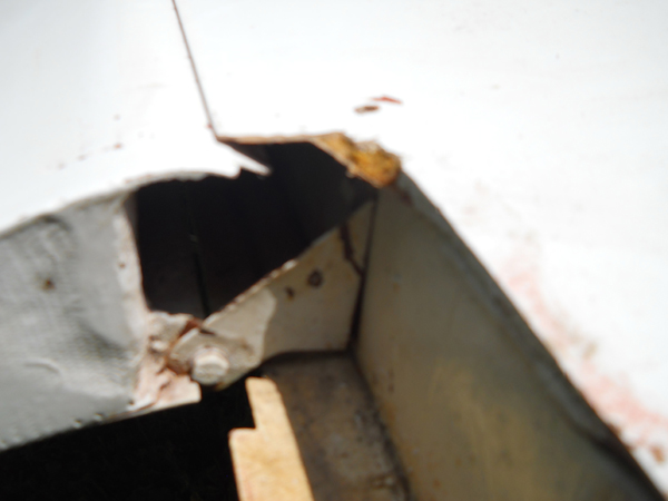

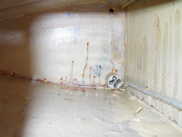

I just return from a wilderness canoe camping trip in New York's Adirondack Park to find you have overcome yet another problem. I like your idea of ducting cabin heat off the airbox intake. I also know how hard it is to work in extreme heat and humidity conditions. My dad and I rebuilt an Ercoupe and when we brought it back to the hanger to finish it off over a couple of summers the heat inside the back tar coated roof was unbearable no matter how early we arrived to work on the airplane. I hope I have as good as results as you when it comes to solving some of my dilemmas. I have attached a few pics of a couple of things I need to address:

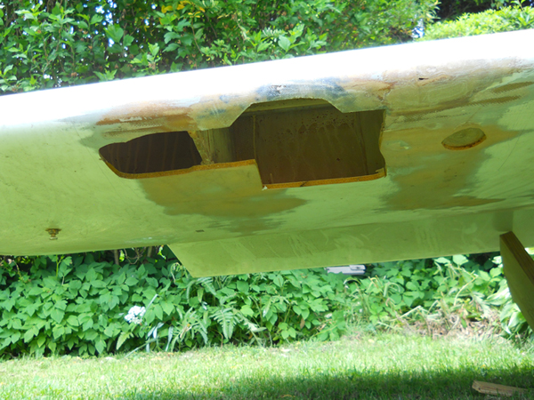

Underside of wing-the scrap on the right is from the time Ken ran over the runway light at Oshkosh. The scrap on the left from the hole in the tank is from Kens last flight when he hit a fence post, maybe a result of the tail being cut off. The way hole is cut in is a lesson on how not to prepare to patch a laminated composite structure.
Flap hinge-as the airplane rolled over the fence post it caught on the flap hinge and bent it. The wing came to rest on the post about a foot out board on the flap. That gouge has been patched.
Inside the slosh tank-Ken took a different tack on the fuel tanks, they do not have to standard flapper system to close the tank, it has some kind of metal ball in a track that seals off the tank. He also did not coat the tank with the prescribed two coats of resin he used a slosh compound. A cool idea but after 20 years it is peeling of in areas like the tank filler and bottom fuel tester drain where the resin is real smooth from gluing in these parts.

Regarding the fuel tank....Good luck with that. I have NO idea how to fix except sand and try to recoat with Jeffcoat or something. The flaking looks really bad and I wonder if the second bay is as bad. Makes me want to scope out mine before I go any further.
The flap hinge doesn't look too bad from the photo but may need replacement if binding.
The hole in the wing looks like a reverse construction process. Layup two or three ply flat sheet of fiberglass with peel ply on one side to make good bonding surface. Fit the sheet to the inside of the wing hole and bond all the way around. Fill in the middle with foam and bond to the inside skin. Finally, glass over the outside and flair into existing skin. The result should be just as strong as the original skin if not a bit more so.
Sounds so easy doesn't it?  The devil is always in the details though.

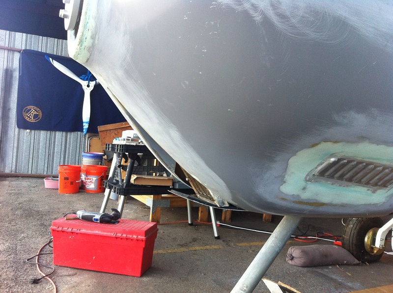

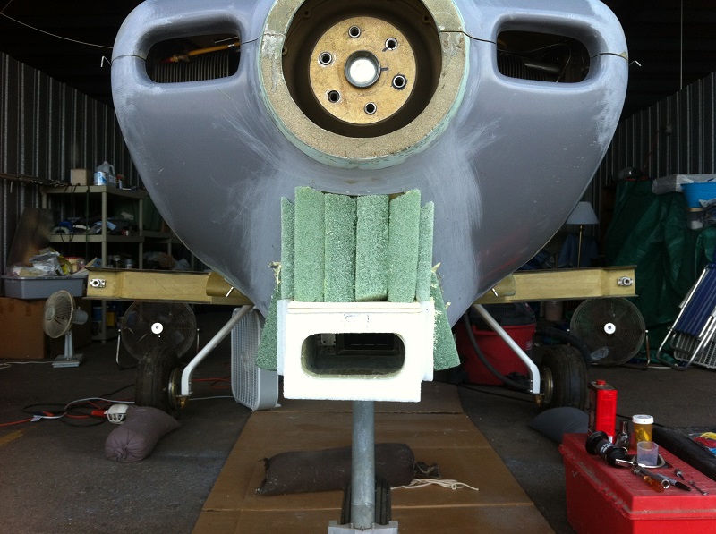

I am having to do much the same operation on the cowling trying to fabricate an air scoop. It sure looks funny in the intermediate stages but I am hopeful the final result won't look quite so odd. It would have looked a lot better if I has used the same color foam. I will try to get back to it this weekend and start the shaping with a rasp and sandpaper. I figure it will take a couple of weekends to shape it, fill it, shape it some more, fill it some more, and then start the glass work. Followed by more sanding, filling, and repeat until sick of it. The foam I am using can easily be shaped, filled with epoxy micro mix for a bondable surface and then be dissolved with Acetone when finished. It won't look pretty on the inside but I can live with that. I am doing it all in place to make sure the air inlet is properly positioned for the air box attachment.
It is hard to see from the photos but the underside is a flat sheet of 4-ply fiberglass that I fabricated for some other parts that I cut to form the bottom of the scoop and cowling. I used pop rivets and bonded  (belt and suspenders) it to the existing cowling bottom. When it took the rounded shape it carried it forward to help flair into the existing contours. I will post additional photos of the process and the completed cowling. (BUT ONLY IF IT COMES OUT LOOKING RIGHT)

I had to repair a fuel leak in my TR-1 and I decided to cut an access hole in the top of the wing and then patched it just like fabricating a access panel. This would allow you to reinforce the repair of the bottom of the tank and even recoat with epoxy or other tank sealer. The patch on the top has very little head pressure compared to the bottom, when the tank is full.

PostPosted: Thu Aug 08, 2013 10:40 am    Post subject: How long does it take to build an throttle body airbox? Reply with quote
Bob,I'm sure that will be an efficient air scoop but the front of your plane is beginning to resemble a locomotive rather than a streamlined airplane.  Couldn't the scoop be curved upward and follow the the cowling shape somewhat?  Just a thought from a retired industrial designer.

Al,
The air box ended up an inch below the bottom of the cowling before I started with the connection to the scoop. I was able to bring that up a little and keep the bottom aligned with the bottom of the cowling. The air inlet extended the connection forward even further below the original cowling shape.  The current layup gives me some wiggle room to shape it and cut it back some but my main goal was to keep the smooth flow. What you see right now is a lot of extra foam that will be cut away as the shape is developed. The attached photo shows the basic shape that I am going for and that will transition into the existing cowling shape as much as possible.
Please let me finish it before you start labeling it a steam locomotive.

Mark,
Looks like you had a great trip, wish I had been there, looks great.
Bob Reed
Making slow but steady progress.

Hello Robert,

Hi Mark,
I have all piano hinges on my flaps and no problems. I also run about 35 degrees of flap.
If you go with the jeffco fuel sealer then Lancair has by far the best price as of a couple months ago.
Larry out in CA had the same problem with the sealer pealing off on this airplane. He used a 6 inch hole saw to access the tanks.
Scott

I used the airbox, air scoop, and baffle kit from vans on my airplane. I had to modify them in places and graft the scoop onto the existing cowl, but it was a great starting point. The baffle kit saves tons of time.

Why is the throttle body so long? mine is half that long...

On Aug 8, 2013, at 3:20 PM, Robert Reed <robertr237(at)att.net (robertr237(at)att.net)> wrote:
[quote]Al,
BOB

Scott,
The throttle body is just an air control unit which in my mind should be shorter but the dual sensors for manifold pressure and temperature required for the FADEC system take up a large portion of the height. The blue tape is covering the mounts for the censors in the photo. They also protrude out several inches from the throttle body not including the wiring. I looked at the filtered air box from Vans. Another builder on the field has one and I looked at the measurements and they would have required me to also cut the bottom out of the cowling. I might have been able to use the Vans scoop but it would have required almost as much surgery on the cowling. The main difference though is going to come down to cost. When I am done the total cost for the air box, scoop, and modifications will be about $75 vs several hundred for any other option. Cost in time should be about the same overall.
I did get the baffle kit from Vans and you are right, it was a great starting point and saved considerable time. I used it to create a pressure cowling shown in the photo. Used piano hinges to provide quick easy access. My concern living in Texas is getting maximum cooling to the engine which is why I am using a pressure cowling along with vents on the side of the cowling. I am still concerned about getting enough air through the engine with the use of 4 into 1 exhaust. I am a bit concerned the exhaust system will block the air from the rear of the cowling. I am hoping I will have enough air flow.
Bob

[quote]Scott,
http://www.vansaircraft.com/cgi-bin/store.cgi?ident=1376017121-472-6&browse=engines
Scott
Al,
BOB
Al
Bob Reed

Hello Robert,

Attached is a pic of the “locomotion� end of Scott’s - King of all KISes. It shows the RV scoop and how he blended it onto the stock cowling. The part is about 80 bucks, but would remove the individuality that you have expressed in your build so far. I must say Robert when I look through the pics of your build your level of quality and innovation is first class. When Ken McCormick built the airplane I have he spent 500 hours to complete the airframe. When I look at yours I see more than 500 hours in the cockpit alone. Keep on Cruisin’.
Thanks everybody for you input on my fuel tank situation. One thing I should have mentioned is it was fueled with auto gas. But it only flew about one year and there appears to be no damage or any signs of leaking, plus all the fuel leaked out of that big hole anyway. I plan to check the tanks out thoroughly with some kind of bore scope. I hate the idea of cutting holes in the wing but I will do what I must. Mark K – how about this idea, if I can’t use the existing tanks-use the wing tips from the last rib outward and maybe make longer wing tips?

Hey Mark,
Harbor freight has a cheapish camera on a flexible arm thing. Works pretty well. Be sure to find a 20% off coupon. They call it a digital inspection camera.
Scott
