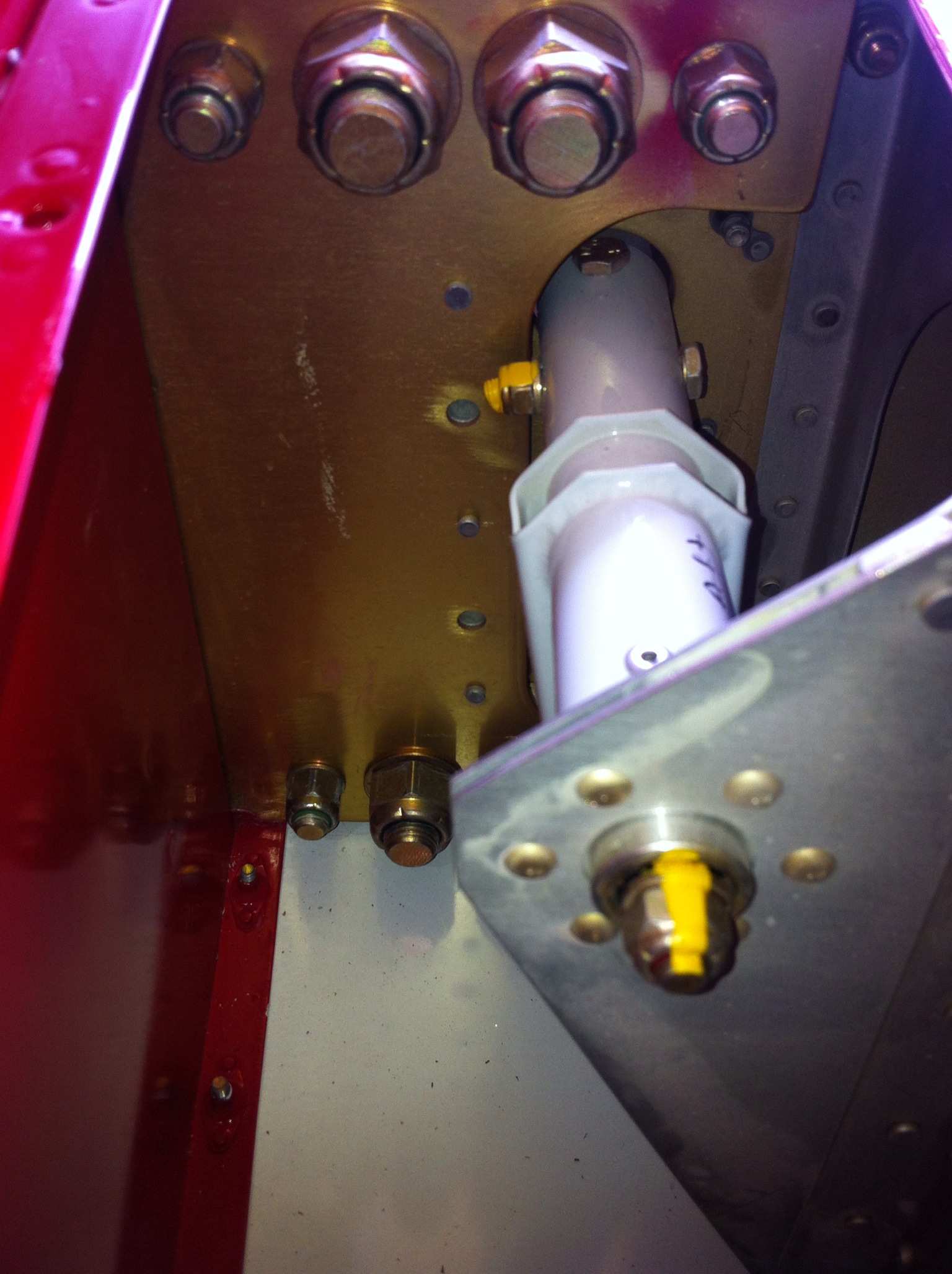

Hi,
I can't find in the plans which bolts to mount in the two rear holes of the center section (see picture) a nutplate is attached inside of the center section on each hole. An AN-4 would fit but I still miss the reason for having a bolt there.
I didn't find anywhere in the plans what bolts to put in there.
Michael

Two AN4 bolts, shown in the plans on page 44-11, figure 2.
Help hold the "upright bar".

Thanks Bob, I just realized I didn't look at the revised Plan for 44-11.
