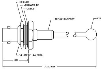

Well, that cheap TED xpdr antenna is backordered. I came up with a few different lengths, googling. The diagram below shows it's ~2.5" from the ground plane (aluminum skin). Also read on the sequair site it would be 3.1", but that could be for a non-aluminum plane.
http://www.seqair.com/skunkworks/Antennas/TpxAntProbs/TpxAntProbs.html
Dan
PS: Does that 5/16" ball at the end effect the antenna length? Does it reduce drag??

I believe the 3.1" dimension on the Sequoia site is the overall length of
the rod not the portion beyond the ground plane, and yes, this is for a
wooden aeroplane with a relatively small ground plane. The article also
speaks to a larger ground plane having some effect on the length.
Bob McC.

The 2.9" figure for overall length above the ground
plane is fine. The article fails to mention that the
'resonant ground plane' has a radius equal to the
height of the antenna or a diameter of 5.8". Alternatively
you go with the non-resonant ground plane (like a belly
skin) were exact dimensions are LARGE compared to
2.9" but operationally insignificant.

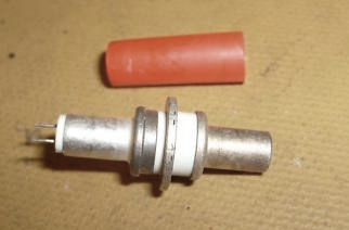

The thing about every antenna needing to be tailored
to an installation is bogus. Early transponders used
a one-tube transmitter consisting of an pencil triode
as an oscillator operating at a frequency controlled
by a resonant cavity.
[img]cid:.2[/img]
These transponders could be 'pulled' off-frequency by
the effects of antennas. Modern, solid state transponders
are not so afflicted.

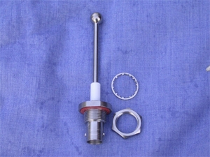

If you're building for a non-metalic airplane, 2.9"
is the magic number for antenna length and radius
of a ground plane. For a metal airplane, go for 2.9"
antenna on an 'infinite' ground plane.
In any case, metallic joints should be electrically
'tight' . . . solder is good. You can pick up one
of these for about $20 shipping included.
[img]cid:.3[/img]
http://tinyurl.com/lulfq5z
You would mount this on a 2.9" radius disk for use
in wood or plastic airplane.
