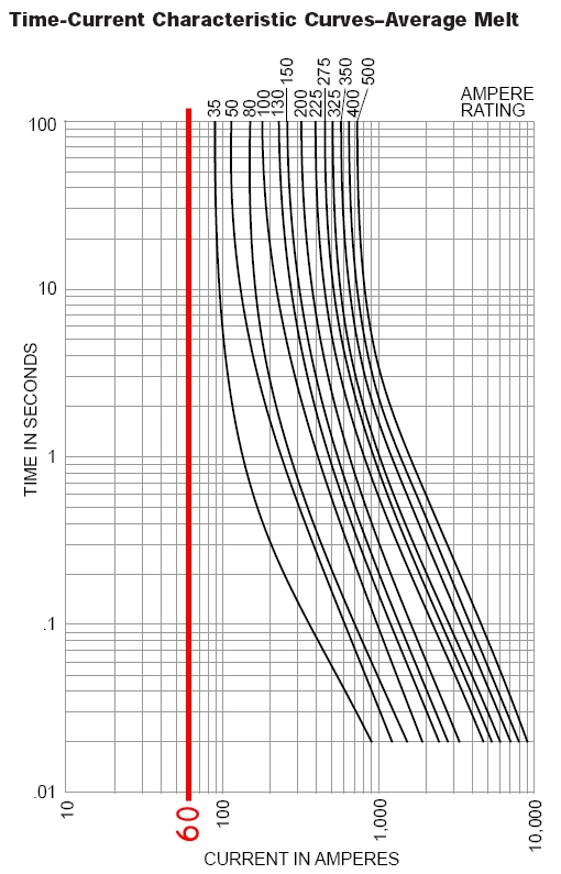

Your b-lead protection would do well to emulate
Beech and many others by switching to current
limiters (VERY robust fuses) on the firewall.
These DO NOT nuisance trip but will perform
intended functions for shorted diodes.

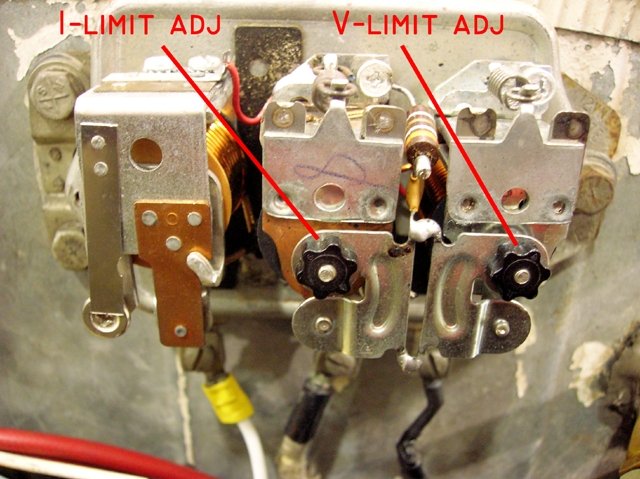

Too many of our brothers in the heavier iron business
believed that 60A nameplate rating for an alternator
was a limit. Regulators for the generators replaced
by alternators featured a calibrated current limit control
relay. In this case, generator output and nameplate rating
were in lockstep.
[img]cid:.0[/img]
An alternator is inherently current limited but at a
value dependent on temperature. The nameplate rating is
worst case for max allowable operating temperature. In
OTHER conditions, the user should expect MORE than nameplate
output.
Failure to understand this feature prompted the folks to
keep the same breaker-to-nameplate rating as for the legacy
generators thus setting the stage for the relatively rare
but significant breaker tripping in response to a predictable
and expected operating condition. This drove my recommendations
for following in Beech's footsteps and using uber-robust
current limiters for b-lead protection.
[img]cid:.1[/img]
Note that a 35A ANL limiter will carry 80A at room
temperature for ever . . . but hit it with a shorted
diode fed by a battery and it opens in 100 mS or less.
This style of protection will not nuisance trip.
