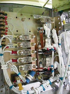

Crew accessible b-lead breakers have pretty much gone
the way of the ADF and LORAN receivers.
B-lead protection moved out to the firewall on Bonanzas
about 35-30 years ago.
[img]cid:7.1.0.9.0.20130729161236.020c35c0(at)aeroelectric.com.0[/img]
Not sure what the philosophy is for current
single engine production. I'll have to see
if I still know anyone at Cessna or Piper.
