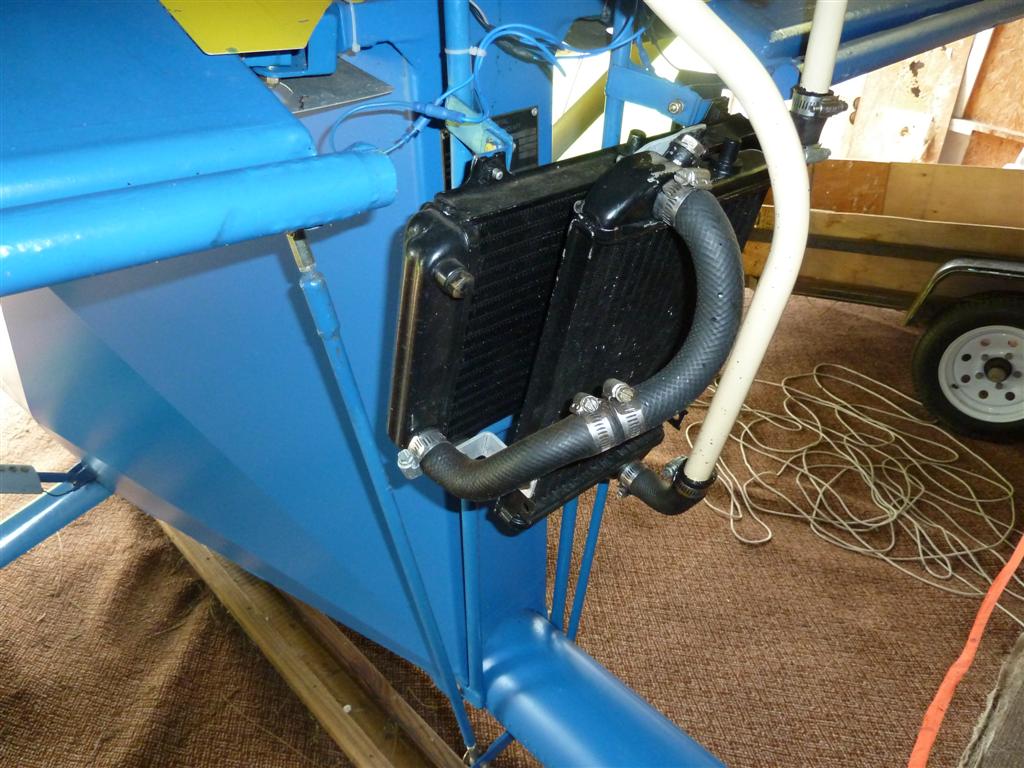

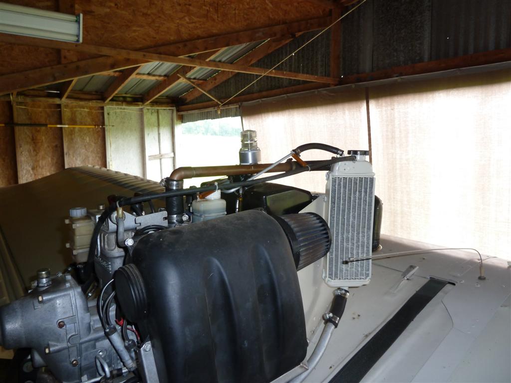

Here are some hopefully useful thoughts on radiators - the Rotax radiator part # 995-699 measures 10.5" X 11" x 1.25" thick which equals out to 115 square inches. It costs $439.
My MKIII N402RP is using a motorcycle radiator purchased for $75 from the local motorcycle scrapyard, it is off some sort of street cruiser, a big Honda, don't remember exactly. The radiator measures 16" x 7.5" x 1.25" or 120 square inches. The FSII with 582 is using a similarly sourced radiator, it measures 15" x 8" x 1.25" once again 120 square inches. In both cases the radiators were mounted below and behind the wing and engine, where prop draw and below the wing airflow will help move a lot of air through them.
On both airplanes we had excellent results most of the year, but we had a little trouble in the heat of summer on extended hard climbs, the temp would get close to redline and we would have to slack off a bit, let it cool down, and then go again. Given that the Rotax radiator is slightly smaller, it would not be surprising if other 582 operators also had some heat problems during the heat of summer.
So here is how we fixed things: added a second radiator. In the case of the FSII, we just piggybacked a second smaller radiator off some forgotten bike behind the original, problem solved. (You bleed the air out of the piggybacker by loosening the big top bolt)
On the MKIII, I decided to get rid of the brass Rotax expansion tank that is normally used to add water by just adding a dirt bike radiator instead, and attached it to the fairing that goes in front of the engine and holds the oil tank. It doesn't even face straight ahead, it is at an angle, because that lets the pipe fittings line up better, and the fairing will get the air in just fine regardless. Since all these radiators are aluminum, the added weight is minimal.
Temps now stay constant year around on both airplanes.

Richard, If you ever do it again, get a radiator off an 80's Honda Magna. Doesn't matter whether the 750 or 1100. I've put them on a gray head and a blue head. Never had a cooling problem. When I flew the Mk IIIX with the blue head home to her owner it was 116 degrees in my backyard when I taxied out for take off. I climbed directly to 6500 (5000 agl) and temps never got out of the green.
