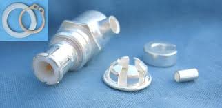

I'm installing a transponder in my Sonex. A couple years ago, I bought a 9-30-10 TED 90 degree coax adapter fitting, shown in the attached pic. What are the C ring and small cylindrical shaped items for? Any instructions for soldering this?
Dan

The circlip and washer are to secure the connector into a panel using the
groove around its "nose". The cylindrical sleeve is to adapt the connector
to different diameters of coax. (link to instructions sent separately)

A picture is worth a thousand words. I'm guessing I won't need that barrel adapter, but I'll find out when I put things together.
