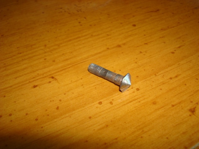

An un-drilled floor panel that I recently made for my GlaStar was placed in position. I could see the mounting tabs
beneath the panel from the front of the plane, but no where near accurate enough to be to place a locating pen mark
on the topside to drill the holes.
So!! I took an old 3/16" bolt, chucked it into my drill, and turned on my bench grinder. I spun the bolt head against
the grinder creating a pin-pointed top. It sort of looks like a rivet, but instead of the head being rounded, it came to sharp point.
Then, I lifted up the floor panel, dropped the pointy-headed bolt in place, re-positioned the floor panel exactly where I wanted
it to be located. Then, I took a small block of wood, roughly centered it above the first tab, on top of the panel and TAP! Next,
removed the panel, looked for the tiny dent, and then centered punched it a little better, and drilled it out to 3/16".
After placing the floor panel back into position in the floor, I dropped in a bolt….exactly locating the panel where I wanted
it! But, before I had set it in place, I dropped that pointy-headed bolt into a tab on the opposite side of the panel. Then TAP!
Voila'!! Second bolt hole dent. Removed panel, center punched second hole, drilled 3/16", and re-installed.
Once you have two bolt holes drilled, and the 2 locating bolts inserted through the panel and their corresponding tabs (on opposite
sides of your panel), that sucker is EXACTLY positioned where it needs to be, and then you just keep on working your way
around the remaining tabs, dropping in that pointy-headed bolt per each next tab to tap a small locating dent on the panel's underside.
I think my custom-made floor panel had about 8-9 bolts to hold it secure. Each one of those holes was as exact as they could be.
It was as if I had access to underneath the tabs to drill them.
I think this method offers several variations of uses to allow the builder to make very precisely located blind panels. Below is a duplicate
of the bolt I ground down. It needn't be any fancier than a beat up old bolt, ground down to a sharp point!! BTW, the 1/8" height that it holds
the panel up is a non-factor.

You are very welcome, Rick. I am glad I could help.
By the way…..I got to thinking a little later about that how that method could be used on lots of things,
like if you needed to mount wheel pants, or an instrument panel, or anything is that is pre-made, and yet you have
established holes you need to locate it on that get hidden. All you'd need to do is do the first one, and the rest of them fall in line
fairly quickly.
I didn't know they already made commercial versions.
