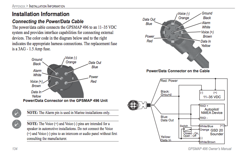

If you have all the pieces, the best thing to do would be to try it out on the bench.
When I talked to Garmin a few years ago about connecting this unit, they said it was fine to parallel it to several devices. I *think* they said up to five.
Do you have any devices that need to talk back to the 496? If so, that is the only device that should have its Tx line connected to the 496 Rx line. (you can't parallel these)
Otherwise, I would use a twisted pair for 496 Data Tx and 496 Data Ground, and run them from the Garmin to each instrument in a star-pattern. The screen is probably optional, depending on what else is in the wiring harness with it and how far it's going. Things that might be sensitive to digital noise should be guarded, and it should be guarded from strong RF sources like antenna feeds. These are just suggestions though. In a lot of times, within reason, it's just 'whatever works best'
Bob and I differ on where to terminate the screen, but that drills into some serious minutiae on this project. It's probably just not necessary at all. (Bob -- I wouldn't mind hearing your thoughts on the termination location rationale though)
Oh, and just in case you get some funny ideas, the Tx 2 and Rx 2 lines that are in that Garmin-made wire harness are not connected in the 496! I think they are for the 296 only..
I found an extra Garmin power data cable laying around and I've included a drawing showing how I would wire the system and a page of the installation manual with some useful warnings. Looking back at my notes, though, in the install I did it looks like I didn't even connect the serial ground to the D100. When the instruments are inches apart and inches from the ground terminals, all this star-grounding and shielding starts to make less difference.
