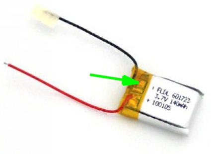

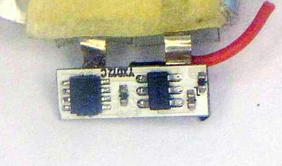

the batteries . . . (1) and NOBODY KNOWS about their historical performance in airplanes . . . their history is a tiny fraction of that we understand about SVLA. (2) Should we be considering some new regulator design that plugs into the maintenance connector on these batteries? (3) I do know that early drop-in replacements for SVLA proposed on biz-jets INCLUDED internal battery monitoring and maintenance electronics. (4)If Boeing finds value in doing it, should we adopt the philosophy? Take one of these batteries apart . . .
[img]cid:7.1.0.9.0.20130719122934.03c895a8(at)aeroelectric.com.2[/img]
. . . and you find something like this inside.
[img]cid:7.1.0.9.0.20130719122934.03c895a8(at)aeroelectric.com.3[/img]
If the suppliers of lithium products onto my grandson's helicopter
find value in perhaps doubling the price of a toy battery
to shepherd it's life in the consumer wild, how is it
that other lithium products can be offered into
operating conditions that are at least as abusive
if not more so?
In the best of all worlds, somebody would finance an
investigative activity into the claims for plug-n-play
capabilities of lithium products onto airplanes.
At the present state of my knowledge, I haven't got a clue.
