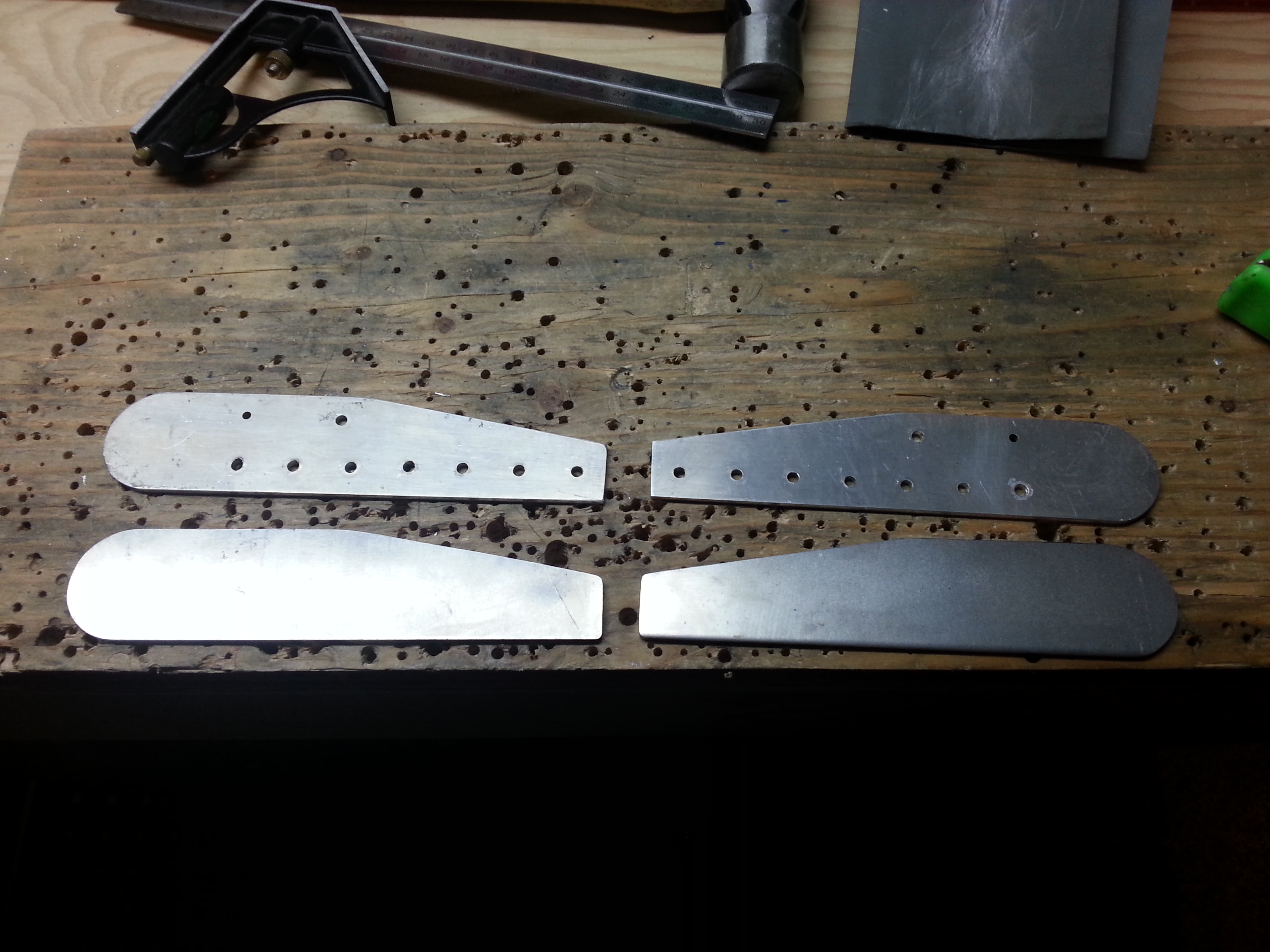

PostPosted: Fri Jun 21, 2013 7:27 am    Post subject: Re: Old kit new problems Reply with quote
Here are the new mounts I built last night out of 1/8th inch 4130 chrome moly.
 Filesize:  1.57 MB
 Viewed:  11650 Time(s)
