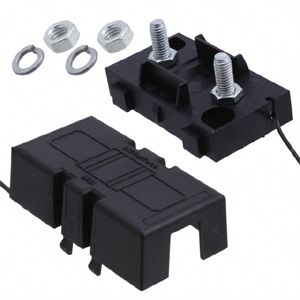

Here's a 40A MIDI style stocked by Digikey
http://tinyurl.com/mpudgxu
and a holder like this
[img]cid:7.1.0.9.0.20130731150249.020c51e0(at)aeroelectric.com.0[/img]
To mount it can be found here . . .
http://tinyurl.com/kcbyc79
 Filesize:  47.84 KB
How do these compare with the ANLs that B&C sells? Other than being a LOT less money? Smile
Do they have a greater tolerance? Slower speed (of reaction)? Don't last in a harsh enviroment?
PostPosted: Thu Aug 01, 2013 6:01 am    Post subject: B-lead protection Reply with quote
Here's the data sheet on MIDI fuses
http://tinyurl.com/l985dtj
Here's the data on ANL . .
http://tinyurl.com/k7o3l3q
The ANL has been around for about 80 years
and is still used in new design. Premier
was the last airplane we designed with a
majority DC power system in it. The distribution
panel contains a goodly number of the ANL style
limiters.
The MIDI's have roots in the automotive industries
where we have witnessed a continuous evolution of
designs. For example, cartridge glass fusses
got replaced by ATC plastics which in turn have
been superceded by the ATR micro fuses. All three
generations perform to their manufacturer's specs
and have been found suited to task in billions of
applications.
The ANL and MIDI are not drop-in replacements
for each other as you can deduce from their
performance curves. But the differences are
insignificant to our task. The advantage of
the more modern design is that they are made
in relatively large quantities on automated
machines for markets much larger than the
markets which nurtured the ANL devices.
Until recently (last 10 years or so) the
modern replacements for the ANL were not
as convenient to acquire. You could find
the fuses as after market service parts but
holders were more of an OEM item. But now
that Digikey has partnered with Bussmann
and Littlefuse to distribute them, procurement
is much easier.
