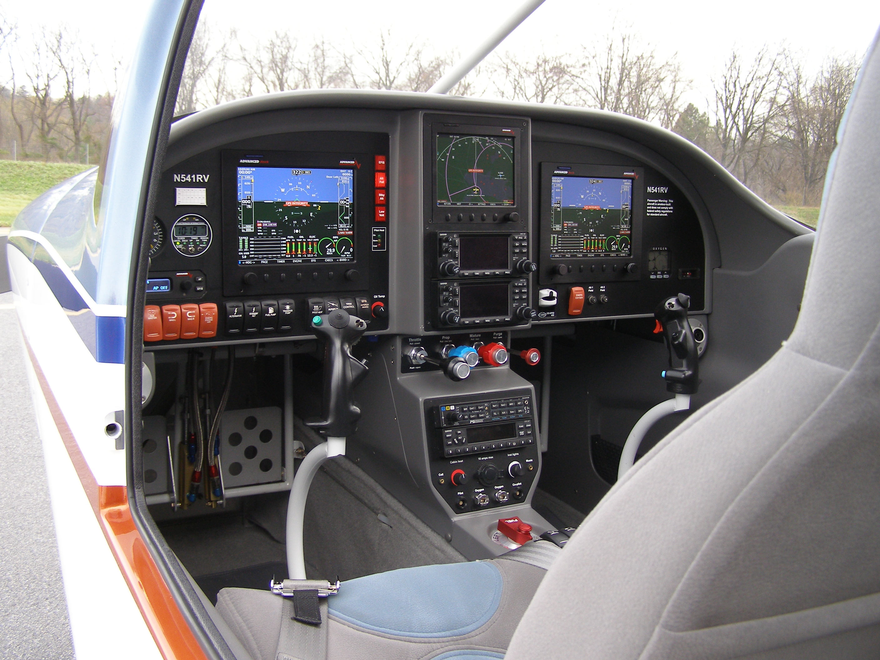

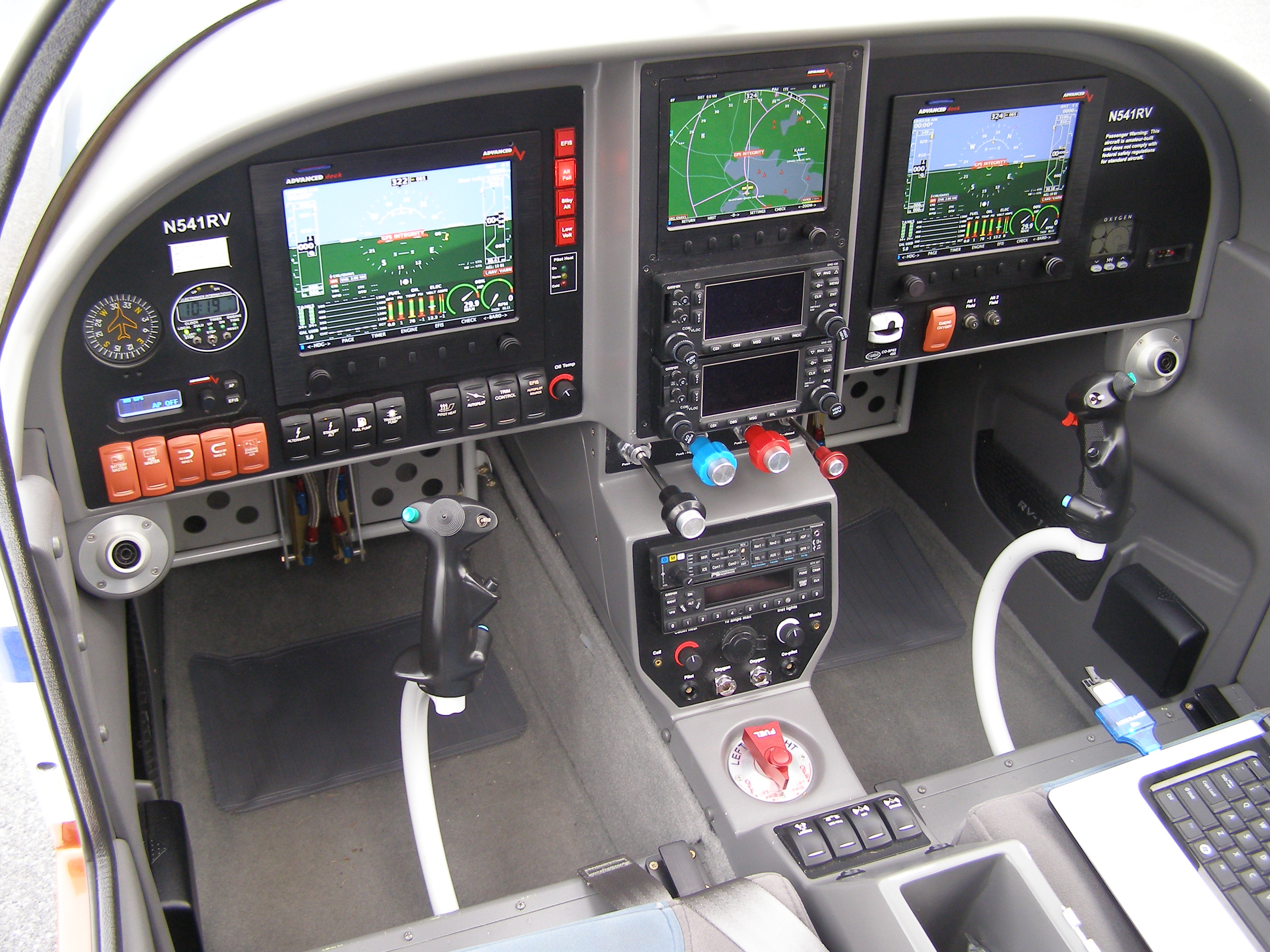

Since I have an Aerosport Products’ instrument panel and I have a relationship with Aerosport Products (I manage the website for them), I went with Geoff’s rocker switches. They work just fine.
I did use the ACS keyed switch, since I only wanted to carry a single key for the ignition, doors, and baggage door.
Almost all my switches are rockers. I have only one color coded switch, the rest are all black. I started to color coded them, but quickly realized all the same colors were grouped together. i.e. a bank of four all red. Since the banks of switches all have different functions, I used the physical placement to differentiate rather than color.

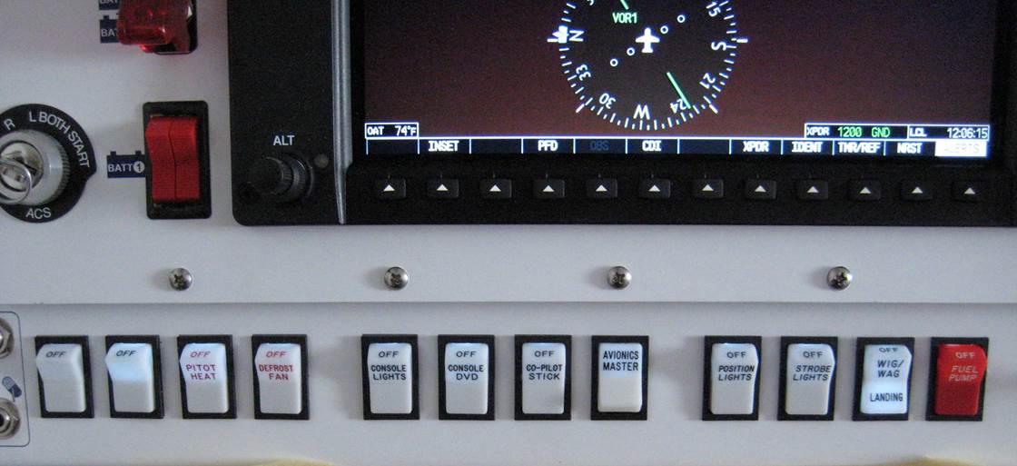

I used the Aveo switches and had a few custom laser engraved.

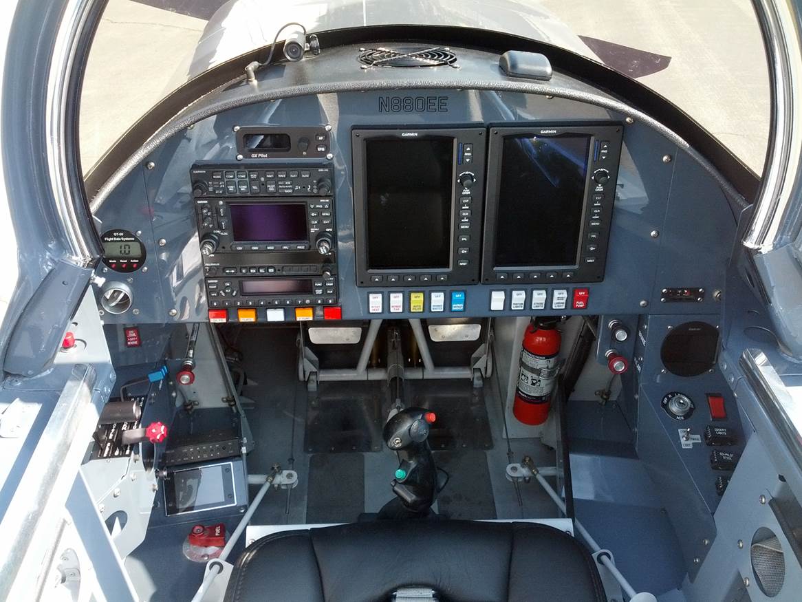

PostPosted: Mon Jul 08, 2013 8:39 am    Post subject: Choosing the switches Reply with quote
On 7/7/2013 8:11 AM, Jesse Saint wrote:
The classy rocker switches are very nice to look at, and I like the way they can be labeled right on the switch, but they are more expensive and harder to add or remove. I recently worked on a plane that had all rocker switches (the big black ones that were engraved with labels. There are 4-5 switches that aren't used any more and if I remove them, there will be big holes in the panel.
I used white Honeywell rockers (AML34,24) with labels and backlighting.  All the above certainly applies though I haven't had to face any of that yet beyond initial expense.  My selection was based purely on personal desire with the knowledge that toggles would be easier, cheaper, and more flexible.  But since I did my own panel, I enjoyed the challenge and the finished appearance.
I didn't include a split rocker, nothing missed there.
I did use the ACS key switch and find it a good selection for my '10.  It's easy to leave the baggage key dangling outside unless you have to have it to start the plane (there are other approaches to this problem but this one works).  Since you need a key for the baggage door, using the same for ignition and just plain requiring a key ring is a handy thing (my fuel key is on the ring too which is a great reminder).
Re the Honeywells - finding the right switches for a couple of functions required some searching, e.g. AP source switching, flaps.   Newark Electronics turned out to be a great (stocked) source for switch items.  Cutting rectangular holes in an aluminum panel turned out to be surprisingly easy with a hand file.  The lights for the switches turn out to be troublesome... it takes some fooling around to get the little lights to consistently stay lit in a vibrating environment.  There are LED lights available as well as the standard incandescent.  I use the LEDs but went to incandescent for my LRC3 low voltage lights in order for them to function properly.  B&C can tell you how to make the LEDs work there as well.
I used AML41 indicators for the idiot lights.    Very  handsome when combined with the rockers.
I used dimmers on all switches and 2 of the idiot lights.

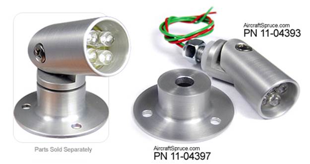

PostPosted: Mon Jul 08, 2013 9:13 am    Post subject: Choosing the switches Reply with quote
To pile on what Bill said I used the backlit Honeywell switches (with dimmer) for the -10 and like it a lot but when it was time to build the 8A I used the same switches but unlighted. It saved 30-40% on some of the switches. I used a metal Red/White LED cockpit light that can light up the switches (and/or charts) when needed.
I also placed some LED strip lights under the longerons that give a beautiful “down glow� and allows me to read just about anything I want while night flying including the switches. Works great and provides a lot of light but still easy to fly/land when dark. Sorry, no photos. L
No VPN, did use Faststack, fuses along with 4 breakers, Z-14
