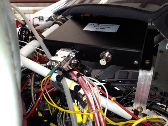

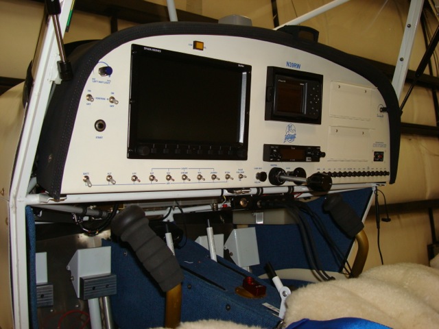

I am looking at installing a Dynon SkyView into a KitFox SS7. I was wondering if anyone else has done this yet and where they mounted the ADHARS and the autopilot servos. Pictures would be a bonus!!

Here's a picture of my 10" Skyview installation. The ADAHRS is inside the upper glovebox (on the right side).
The ADS-B unit is horizontal and the EMS and Mode S Transponder are mounted on the left side vertically below and slightly outboard of the ADS-B.
I opted not to use an autopilot.
The Skyview is outstanding, I think you'll be pleased!
