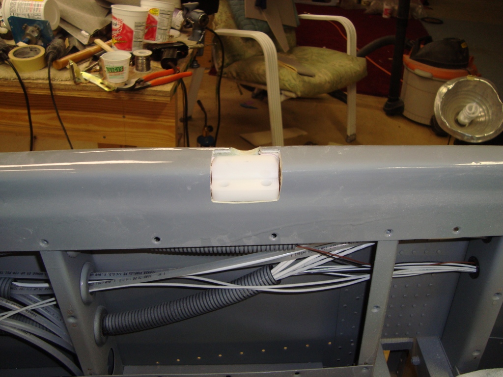

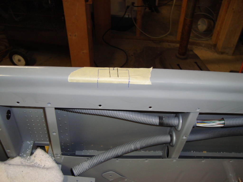

I didn't use the Van's electrical kit but here is how I ran the three
conduits on each side. Note - where these lines pass through the rear seat
pan or ribs I used an adhesive to make sure there was no relative motion
between the corrugated conduit and the aluminum. On the side lightning
holes I added large rubber grommets in the lighting holes.
I figured I needed two runs on each side, but added a third just in case. I
ended up using it. I have the two ADHRS modules mounted aft of the baggage
compartment as most do, so they have two 1/4" lines from the wing going aft
(pitot and AOA) and two going from aft up to the panel (pitot and static) as
I have a couple of analog gauges in the panel. All wire and tubing runs are
in the conduit including the #2 welding cable from both masters to the
starter solenoid.
Carl
RV-8A (sold last week)
RV-10, 95 hrs

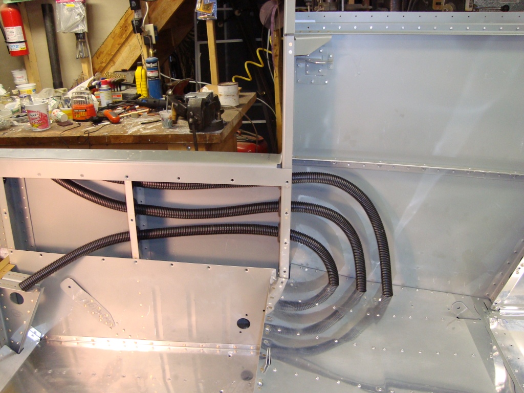

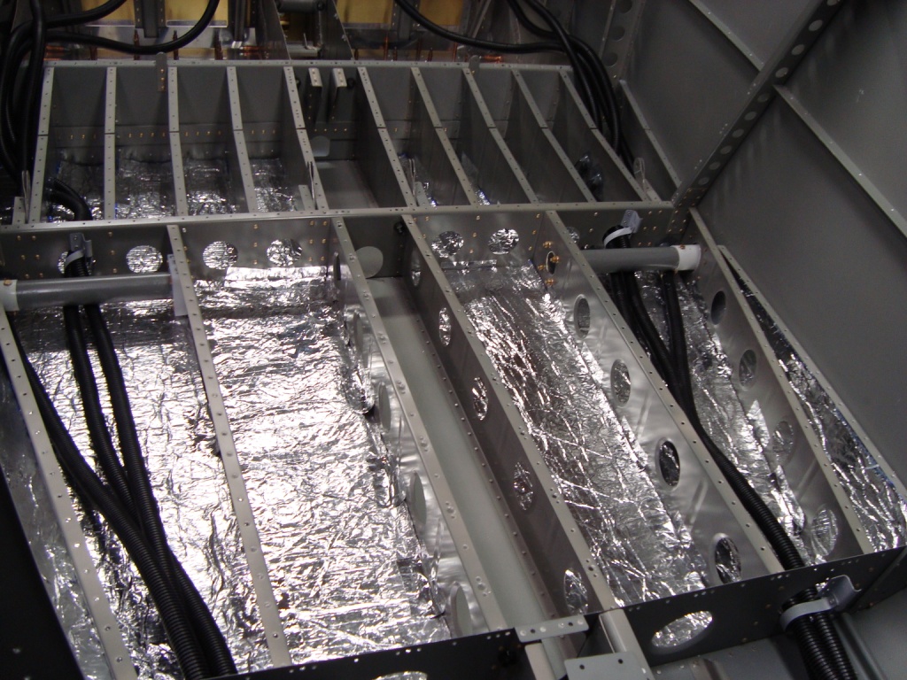

The attached photos are the only ones I can find that have more detail. The
conduit ends after it goes forward through the side rib lighting holes (the
ones where I installed the large grommets). Forward of that the runs just
use snap bushings like Van's has in his plans. I think I had to add one
additional hole on one side.

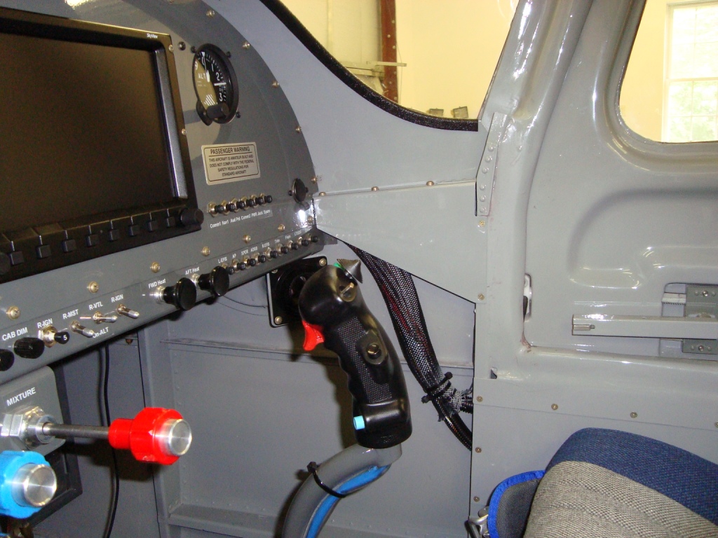

Note - there is no way to get all the wires and such past the panel bulkhead
just using the left side (with the supplied cover plate) per the planes. I
ran a 1" or so wire bundle up the inside of the last right side rib then
past the panel bulkhead in the side channel. I slightly enlarged the panel
notch that straddles the side channel for added clearance. I used some
plastic mesh conduit for this run. Most of it is hidden behind the little
side cover plate (photos #8 & #9).
